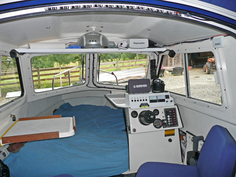

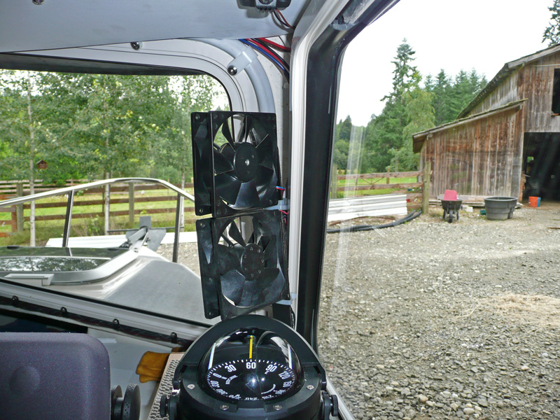

My situation is a little different than yours, because I have a 16 instead of a 22. I installed two computer fans on the starbord winshield to defrost the window.
You can click on the thumbnails for a larger photo.
They work quite well and do not block my vision in any way. Either fan can be rotated individually. For my port window I put another larger computer fan on the table, but it is not a perminanet installition.
Computer fans are usually easy to come by if you have an older computer. The new computers usually do not have as large a fan as the older ones and most servers have larger fans than the desktops.
