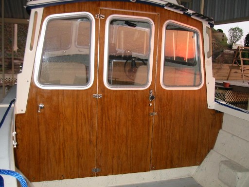

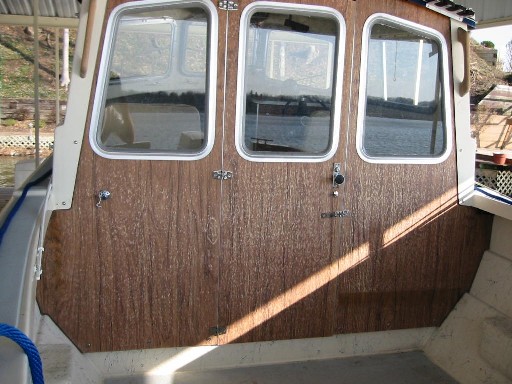

PostPosted: Tue Aug 28, 2007 10:42 pm    Post subject: Reply with quote
Here's some before/after pics from a late friend of ours.
And here are his words describing the process he used.
