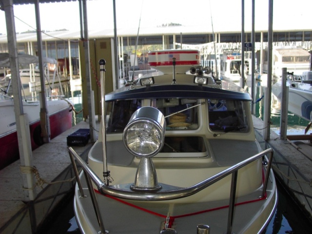

Here's my solution (a common one) to the problem on a C-Dory.
Costs about $350-$450 for the remote controlled light, and another $100 or so to fabricate and weld the stainless plate to the bow pulpit.
The wires go into the pulpit tubing and come out down under the center of the rear starboard stanchion plate in the v-berth.
The lamp has two filaments, one for spotlight use, another for flood.
Additional lights on the brow are for docking, retrieving on trailer.
Similar light set up on rear of cabin makes backing up trailer and launching at night much easier.
More photos on page 1 of my album.
Joe.

Sea Wolf: Your bow light is an awesome bit of rigging! To what extent does it interfere with your field of vision during the daytime? How has the light held up? I'm definitely interested. Mike.
