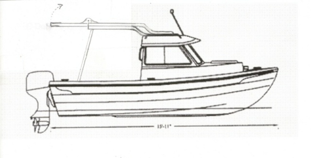

I wanted to start a thread named HARDTOP IDEAS..... and insert a line drawing of a 16 angler I have droped into a microsoft office power point slide, and added a "crewd" idea of what I have mentioned about building a hard top set up that you can flop the aft 1/3 of the section forward when you want to fish or just clear the aft section of the boat of obstrucitions for loading...etc.... but still have the ability to have a full hardtop covering the length of your entire cockpit area.
I used the 16 Angler because there was not a 18, 19 or 22 Angler line drawing on the factory web site.... this will get the idea across...and spin off what RedFox is setting up for his 22. My idea was removeable support legs for the aft 1/3 section for the "flop top".

PostPosted: Mon Feb 27, 2006 9:54 pm    Post subject: HARDTOP IDEAS Reply with quote
Here is another idea
I'm going to install one simular to this in the spring on my 16' Angler
see attachments
