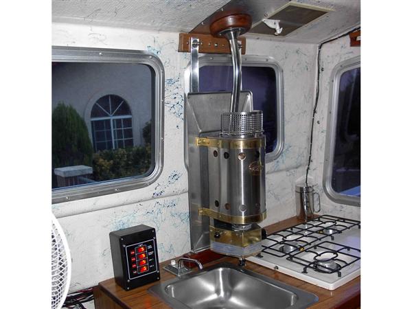

I have a Force 10 Cozy Cabin propane heater for cabin heating ( when away from shore power), and a 3 burner Gaffers and Sattler propane cooking stove.
(Switch panel on left controls carbon dioxide and propane detectors as well as blower motors for cabin heater.)
The Cozy Cabin is easy to use and puts out plenty of heat on half power or less (3000 of 6000 max btu's).
Cooking on the other stove is just like home with three 6000 btu burners that start and stop instantly and adjust from barely lit to wide open.
With this type of set up, you'll need a carbon monoxide detector and a propane detector. You'll also need to install a propane tank properly and propane lines.
The cabin heater will cost about $400, the cookstove $250, the two detectors about another $160, and the tank and lines, etc., another $200, or about $1000 total.
