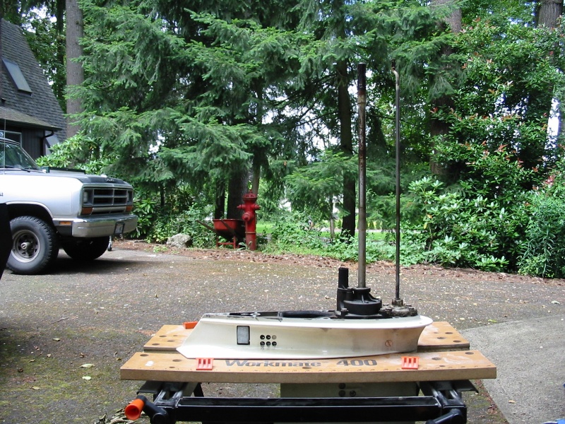

I let mine go for 5 years and while it still worked the impeller had taken a "set" that diminished the performance. Too long. I've heard every year in salt and every two in fresh. Too soon. I'll service mine every two or three years. One consideration is that you don't want to wait so long that your bolts "freeze" and break when you try to remove them. Get a manual and go for it. Here is a Yamaha 115 getting done http://www.motorboating.com/motorboat/boatkeeper/article/0,12696,480308,00.html I used a Workmate to secure my lower unit. It really helped.
