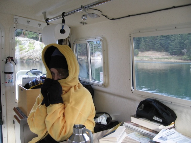

Chris, the starboard bulkhead is to thin to mount an extingisher unless you glue something to the bulkhead to mount it to. I mounted mine by the aft door. The wall thickness is a lot thicker on that aft bulkhead.
Don't mind the women in the forground, she just thinks shes cold.

I mounted an extinguisher in the V-berth right next to the anchor locker door. I thought it would be a good idea to have one at hand at night just in case. Two is all I have on the boat.
