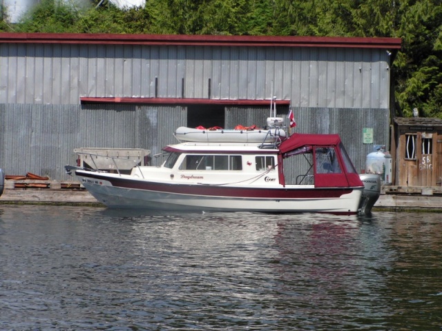

We only have good things to say about our Sunbrella camperback - made by Canvas Riggers in Oak Harbor. We did just notice a zipper had pulled away a bit from the material, so we will need to get it sewed up - but it has completely performed as advertised for us, don't know how we would have done without it on the Alaska adventure. Here is a good shot of ours:
