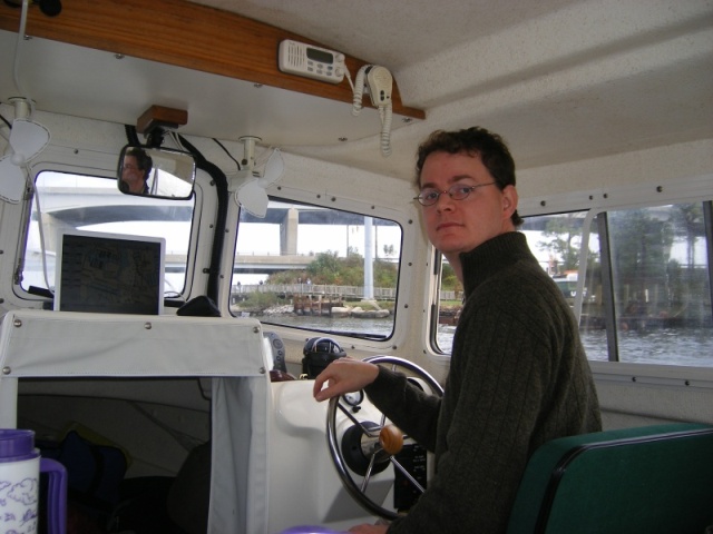

Here's the pic Ben was mentioning...

Ben, The disadvantage I see is that the lap top may obscure foreward vision thru the center window--and if the window is opened, that there is possibility of splash on the computer. RAM mounts make lap top mounts which are flexiable and can be mounted--to hold the laptop on any surface--this is a good solution.

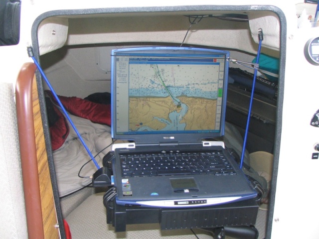

Below is my slightly modified RAM mount. The biggest problem I had was getting an extension that was long enough to more or less center the unit, raise it to a height that allowed easy keyboard access and clear view. Don't remember exactly but I think the extension was 8 inchs long using a 2 inch ball mount. Over time the unit would sag and list to one side and the screen holder lasted one trip. So out came the bungees, nice side effect is that the unit has great shock absorbtion properties.
