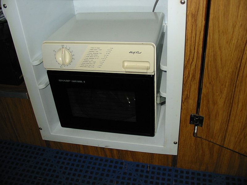

Merry Christmas, I run a Yamaha 1000 that powers my 400 watt Sharp Half-Pint. It needs 760 watts so powering it is not a problem. It sports a rotating carousel, handles a big plate, and fits inside my original ice-box(door removed). These are fine units. The one on Adeline was purchased 20 years ago and still works like new. In fact, I also have one in my kitchen at home. These low power units aren't made anymore but can regularly be found on E-bay. Expect to pay $80-$100. The model you want is the R-1M50. A later model, R-1M53 can also be used but requires a bit more power. Newer ones need too much for a 1000 watt generator. Here is what I use http://cgi.ebay.com/ws/eBayISAPI.dll?ViewItem&ih=015&sspagename=STRK%3AMEWA%3AIT&viewitem=&item=250061134215&rd=1&rd=1

Welcome aboard JK, You sure picked a great day for your 1st post. I need to correct the wattage that I claimed for my microwave oven. It(R-1M50) is 860 watts. The R-1M53(in my kitchen) is 960 watts. The Yamaha 1000 powers them both. Here is a shot of the R-1M50 aboard Adeline inside the useless ice-chest. I'm going to jerk the cooler and install some cabinetry down the road. Maybe even a rollup(appliance garage) door.
