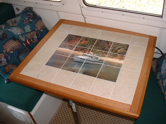

For the past little while we have been quietly working on a special project for our table for the sheer fun of it. Often times we spend a lot of time and money on re-wiring, batteries, wash down systems etc., which are all good, but we decided to do a project just for the heck of it, one that we could just simply enjoy. We went out one Saturday and took some time getting a good picture of the Foggy Dew on Lake Martin, with the fall colors, the water, beach and some old trees. When we were satisfied with the picture we had it transferred on to 12 ceramic tiles (baked in). We chose the surrounding tiles and wood and this is what we ended up with. We really like it and it was a fun time putting it all together. Work in progress pictures in our Foggy Dew projects album. Here is the finished product!

That's slick. Where did you get the photo transfered to the tiles?

Here is a source for Photo Tiles...check around for better pricing.

Very cool, did you overlay the factory table?

There are so many places you can get your tiles done for a huge range of prices. Just do a search for Tile Murals and basically pick one. They suggest using silcone or sandless grout. One big word of caution....do not use sandless grout. Although you can't see it we put many scratches in the tiles even though we were very careful in applying the grout. If we had to do it over again, we would used colored silicone.
We applied the tiles using Liquid Nails to the original boat table after scuff sanding it with course paper. The wood was also glued down with liquid nails.
We are going to replace the original leg, with a nice turned spindle. Haven't found one we like yet. It will still fold up or be detachable. Haven't decided yet on that. Wink
