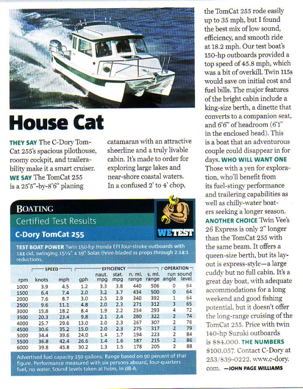

PostPosted: Sun Oct 22, 2006 11:44 pm    Post subject: Boating Magazine November article on the Tom Cat Reply with quote

PostPosted: Mon Oct 23, 2006 12:51 am    Post subject: Reply with quote
I have to disagree with the author--that twin 115 outboards would be adeuate. For the boat to handle properly, the 150's are a definate advantage in accelleration in heavy seas. One cannot take the handling of a light test boat and project how that boat will handle when loaded for actual use--a common error in magazine articles.
We find a comfortable speed to be 23 to 25 knots--and that the boat rides very nicely at 30 to 32 knots--in fact in heavy seas, does better at the higher speed.
I assume that the author meant that the Twin V 26 was $85,000 and the Tom Cat is $100,057--but I think that one would get a mighy bare bones Tom Cat 255 for that price--more realistically, the cost rigged with electronics and trailer is over $120,000--0n up.
I don't think that there is any comparison between the usability of the Twin Vee and the Tom Cat--the Twin Vee, basically has a box with a bunk on one side of it, screwed onto the deck-- We looked at several of the twin Vees-and they all had water on the matress/deck flooring etc.
But I am prejudiced!

PostPosted: Fri Oct 27, 2006 9:04 pm    Post subject: Reply with quote
I've been trying to find the time to register my opinion on this topic. When someone (other than my wife) suggests that my "equipment" might be less than adequate, I guess I feel the need to stand up and defend myself Laughing
I have 2001 Suzuki 115s on our 2006 TomCat (#16). I previously repowered a 1982 Tiara Pursuit with these engines and because our C-Dory dealer was also a Suzuki dealer, they were happy to put them on the TomCat for us. For various reasons, the Pursuit got very little use, so they only had about 50-60 hours on them. I paid "just" $7,500 each for these engines in Portland, ME in 2001. I believe they now go for about $10k-$11K each new, so I guess I got a pretty good deal. When I heard that the factory was recommending 230hp for the TomCat, it seemed a no brainer to slap on the 115s.
So far we have no regrets. We have not loaded the boat with a bunch of extras like t.v., microwave, stereo, radar, a.c. etc. Also, we take short trips (no time for cruising yet) and I never carry more than half the fuel and water capacity. I have only been through rough water once so far, and contrary to Bob's preference, I found going fast to be a bit uncomfortable. Maybe a heavier boat handles the rough water better at higher speeds? Bob may have a point about the extra horse power having an advantage in rough seas, my experience is likely a lot more limited than his.
I wouldn't hessitate to recommend the 115s for someone thinking of purchasing a new TomCat, especially if they won't be loading it down with extra people, gear, and accessories on a regular basis. I can't comment on the gas mileage because I don't have a fuel flow meter. Interestingly though, the top speed is about 37 mph, about the exact same as the Pursuit hull which weighed about 2000 lbs less. This must say something for the cat hull vs. the mono hull in design efficiency.
Anyway, like my wife says (God bless her), it's not the size of your equipment, it's how you use it! Laughing
I would be curious to here if any of the other TomCat owners who monitor this site have 115s and how they like them.

PostPosted: Fri Oct 27, 2006 11:07 pm    Post subject: Reply with quote
Brock, I have to agree with you on engine size. (Not on how to use your equipment. I will leave that up to your wife).
So often people want the largest engine the boat can possibly handle just like in a car. It is nice to have the power to merge onto the freeway, but when will you ever need the power to go 200 mph?

PostPosted: Fri Oct 27, 2006 11:29 pm    Post subject: Reply with quote
Brock
Thanks for the information. My neighbor has a TC 24 with 115's (Yahamas), so I have driven a much lighter boat with the 115's. The base Tom Cat 255 is considerably heavier. It will be interesting to see what type of fuel consumption you find with the TC 255 and the 115's and if it is much better at lets say 25 knots.
Last Sunday night we had 25 knots with 15 miles of fetch--we started up the bay at 6/8 knots--it banged the heck out of us. I asked Marie if she was up "going for it"--"Yep", so we immediately got up on a plane at about 25 knots and the boat smoothed out--there was some noise--and my bad back flared up a, couple of days later--but the boat rode much better. My comments about handling in rough seas were where I was in some 5 to 6 foot swells with 2 to 3 foot chop--and I found that the boat with more hp was much more controlable as it came up onto the larger swells.
We had a Rinker 270 Fiesta V--which weighed about the same as the Tom Cat 255--and had a 350 cu in 300 hp Bravo III duo prop. Our average fuel consumption at 25 knots gave 1.6 miles a gallon. The Tom Cat 255 with 300 hp twin Suzuki gives 2.3 -2.4 miles a gallon at 25 knots--so in our case the cat is more effecient with similar weight boats over the monohull (fuel flow meter). I am not sure that top speed is a measure of effeciency--since different boats need to be proped differently to achieve WOT. I don't know, but if you were hitting the rev limiter of the Suzuki, at 6000 RPM; a slightly larger pitch might give a higher top end--but that probably is not an issue for you.
My past experience in boats leads me to put the higher hp on, as most of us end up putting more weight on the boat. There is no question that our boat is loaded--and we enjoy the air conditioning and generator, as well as the microwave and TV, as well as food for several weeks etc. If we didn't want these, we would have purchased the Glacier Bay. But this is just our choice. I've lived in Richmond VA for two years+--and suspect that AC will be desirable if you do much summer overnighting. (It is almost manidtory in the Gulf Coast) Ed's superstore (if you do your own rigging) has the Suzuki 115's for $7,299 and the 150's for $9,299--or $2,000 more per motor current prices. This is less than 4% of the total cost of the boat. (Assuming that you have to buy motors, trailer, etc)
Glad that the boat is performing well with the 115's. Keep us posted on the fuel burn.
