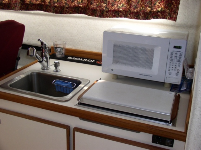

This past winter I decided to make a new galley countertop so that I could move the Wallas forward and have room for a microwave to the rear. The sink was in the standard location, and the Wallas was centered on the remaining space. It worked OK, but didn't make the best use of the space.
While in my shop drinking beer and playing with cardboard templates, I had an epiphany. I realized that it had taken me two years to figure out that the sink had been installed sideways. I knew that it was awkward, but just thought that's what you get with a small sink.
A sheet of Formica, (antique white) over plywood and new teak trim made it look and work much better for me. Now I can get both my big mitts in the sink at the same time. I cut down a plastic cutting board to fit in the recess on top of the Wallas. A pull-out, single-lever faucet and a soap dispenser finished it off.
After living with it for the past season, I can say that the project was well worth-while.

Minnow - very impressive looking. You did good.

Very very nice. Looks great! Wonderful job! Thumbs Up Thumbs Up

Beautiful retrofit job! I have had my 22 footer for six years and I now finally realize that my sink was put in sideways along with everyone else. Brillant on your part to figure this out.

Beautiful refit job! Looks teriffic!
I can sure see how it would be easier to use the sink in the side to side configuration ergonomically, big mitts, or little!
Wonderous insight on the original sink installation, though I doubt the sink comes with up, down, right, left, forward, backward, or any other definite directions, and could be installed as one chose for the application needed.
I think the original C-Dory design was probably choosen to get some space forward along side the stove and between it and the sink to have some kitchen working room, albeit so small to be useless, hence the cutting board cover for the sink.
Best solution to that problem is to fold the helm seat down and add a table top on it to work from, as many have done.

I ordered our boat with the Wallas installed further inboard like you have to provide more space behind. Works great! But I really have to hand it (or should I say 'mit it') to you for the sink! Should we all refer to this as the 'Minnow Sink' now?
I have to think that this would be on the 'must do' list for many, now that we have all been enlightened.

Very nice, quite an improvement!

This is really encouraging. One of the very few things that bugs me about the C-Dory (22, not 25) is the galley arrangement. It just seems a little...awkward. It's great to see what you can accomplish with a little ingenuity. That's one thing I find so charming about these boats.
