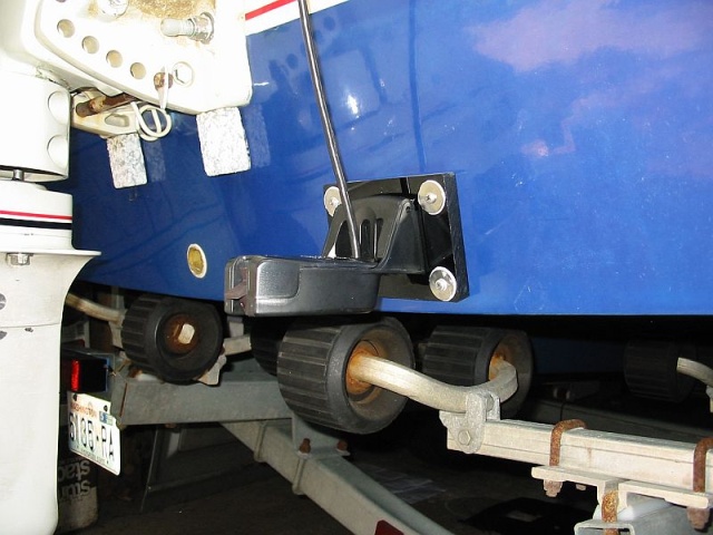

PostPosted: Tue Jul 04, 2006 4:52 pm    Post subject: Reply with quote
Hi JJ, Here is an Airmar P-58 A straight edge layed onto the hull will allow you to position the 'ducer correctly. Aft-end slightly lower. This is from my instruction manual
2. Using a straight edge, sight the
underside of the multisensor relative to
the underside of the hull (see Figure 5).
The stern of the multisensor should be 1–6mm (1/16 –1/4")
below the bow of the multisensor.
Caution:
Do not position the multisensor farther into the water
than necessary to avoid increasing drag, spray, and water noise
and reducing boat speed.
3. Using the vertical adjustment space in the bracket slots, slide
the multisensor up or down until the bottom left corner of the
multisensor projections 0–3mm (0–1/8") below the bottom of
the hull (see Figure 4). When you are satisfied with the position
of the multisensor, tighten the two bracket screws
Pete
