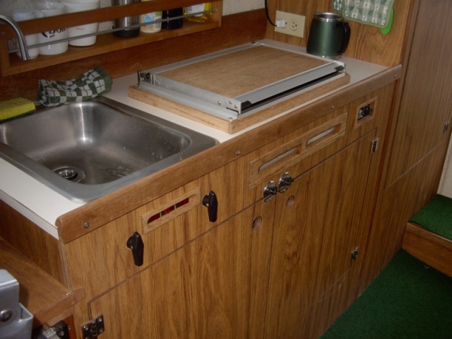

I raised my stove up a little less than an inch to get the fan to blow over the top of the counter edge for better air distribution.

Mike, how about a couple of pics and some details about what you used to raise the Wallas. I have always thought that the 3/4" lip inhibited the airflow out of the Wallas with the lid down.

PostPosted: Sun Apr 16, 2006 9:46 pm    Post subject: Reply with quote
David, I took a page out of your book for the project. Well, I used oak instead of teak. I just cut four strips of oak to 3/4" x 7/8" and made a frame to go around the stove under the mounting flange. The back strip has a couple notches in it to clear the back end of the side stove rails, it's srewed together, and I used longer screws for the stove hold down so they go through the wood. There was some reason I used 7/8" high instead of some other dimension, but I can't remember what it was.
I think you're right about the air flow being restricted some. The slot is pretty narrow in the lid, and the teak edge did get a little warm. My biggest complaint was the hot air was deflecting upward (where the heat wants to go anyway) and not warming the folks sitting at the dinette. I really think the whole cabin warms up quicker with the air blowing straight out into it instead of bouncing off the wood and the ceiling.
I really doubt it is contributing to the overheat problem these folks are having. Under the galley beneath my stove I made wood drawer box that is just a couple inches beneath the stove. I insulated it with some exotic stuff, and installed a large-area vent in the cabinet front. But I have found that I need to keep the lid blower running even with the lid open to draw in enough air to prevent shutdown (I just bent the tang that hits the fan switch so it doesn't shut off). Next time I am in the project mode I am junking the tall cabinet under there and doing something else for the drawers.
I will get some pics next trip down to the boat. You'll be proud of me for the looks of the galley front.

PostPosted: Sun Apr 16, 2006 10:51 pm    Post subject: Reply with quote
OK - here's the Wallas elevator:
You can also the large vent with SS screen right beneath the stove, the recessed control panel to the right of that, and the hot/cold water valves for the sink to the left with the switches for the respective pumps (and an inverter) between them.
