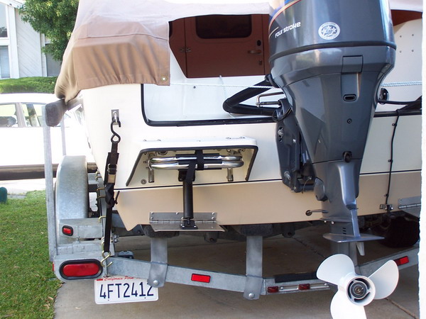

I finally got trim tabs and was doing the install. I was going to remove the swim step and notch a hole so the top cylinder mount could be attatched directly to the stern. After removing all bolts the swim step won't budge. I am sure it has some 5200 holding it on. I used a board and a floor jack to put some pressure on it but it won't break loose. Anybody have some ideas for 5200 removal???
Has anyone just mounted the top cylinder over the swimstep?

I have. Works great. Didn't even need longer screws.

Chris - That 5200 is pretty tenacious stuff but it does have some elasticity to it. I have used this technique several times. By putting pressure on the step, which will show the adhesive line, you can (carefully) use a thin cutting blade like those segmented el cheapos that slip in and out and cut the adhesive slowly, keeping the pressure towards the back of the swim step so if you slip a little, you don't gouge the gelcoat on the stern. It is a bit nerve wracking and tedious, but little by little, you can get it unstuck.
Perhaps there is some liqiuid or paste remover that will soften 5200. Getting rid of the residue is also tedious and I use a one edge razor blade in a holder and slice away a little bit at a time. Eventually just a film is left, and a rough cloth and acetone and gum remover will get the stuff off the gelcoat. No fun and plenty of elbow grease. Can't imagine why 5200 would be used there. A high grade silicone should suffice since the bolts or screws attaching the swim step carry the load. Ask the factory. Good luck.

WhalerGoFar has a point and I have to add to my post that I consulted with the dealer who added the swimstep and he was quite generous with the 5200 on the swimstep back because he considered it a structural addition. He also bolted it as well. IMHO the effort to remove the step to cut a notch would have meant an enormous amount of work for very little gain. Visually one cannot see a difference in tab travel or useage.
On the other hand, removing the step, notching it, preparing the surfaces again and reinstalling it was, in my opinion, a job I could easily mess up and I do that enough already.

Well, I'll let the 5200 win out this time. After some thought I'll take the easy way out and leave the step in place and mount the cylinder to it.
