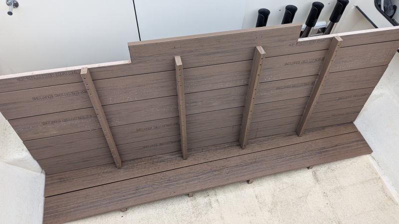

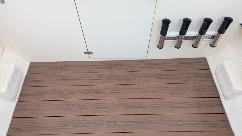

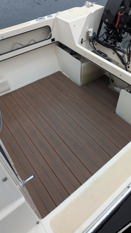

For those of us with older boats that did not come with a factory cockpit floor, I recently built one out of composite deck boards. The removable deck is waterproof and maintenance free, and it has been keeping my feet out of the usual puddle of water that sloshes around. It only took an afternoon to build.
There are some teak and plywood+fiberglass options documented on C-Brats, but I do not recall seeing a solution using composite deck boards. Adding this to the knowledge base...
Supplies:
    Qty: 5, Deckorators Voyage Surestone 1-in x 6-in x 16-ft Mesa Solid edge Composite Deck board
    Qty: 120'ish, Stainless steel screws.

The Deckorators material is the lightest decking I could find with the best surface traction. They advertise it weighing 35% less than traditional composite decking, and I just weighed an offcut at 2.15oz/in. I have not weighed the overall deck, but it should be roughly ~100lbs. From my forum research i recall a guesstimate of 80-90lbs for factory platforms, so the composite decking is not too much heavier. Most of the difference will be the extra (optional) section I installed between the fuel tanks.
I am always wearing shoes in the boat here in the PNW, so surface temperature has not been an issue yet. We'll see if that changes in the summer.
Overall, the boat hasn't sunk and still hits 30mph with the deck, a heavy kicker motor, and full fuel tanks. Very Happy
