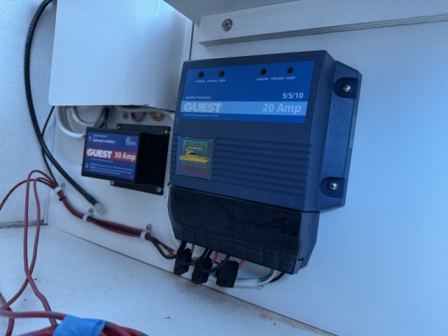

I have a Guest 3 bank charger 5-5-10 that I assume is original equipment for my boat (2008) and does not support LiFepo4 battery charging. I upgraded my house bank to 2 Lifepo4 and start to AGM, I also have a DC-DC charger from each start battery charging the house bank. I do not feel the need to replace the built in charger anytime soon since I do not typically spent much time in harbor. I keep the boat park at my house and anchor for the night while I’m out on the water so no real advantage to have a nicer built in set up. So here is my question, can I use the 10 Amps on one of the start battery and connect both of the 5 amps on the other battery? Having 5 amps on each will be adequate to top off the start batteries but at 10 amps each, I could let the house bank getting charge from the DC-DC charger. I do have a portable charger for Lifepo4 that is easy enough to use for the house bank but plugging-in the boat through the shore power and flipping a switch is even easier.

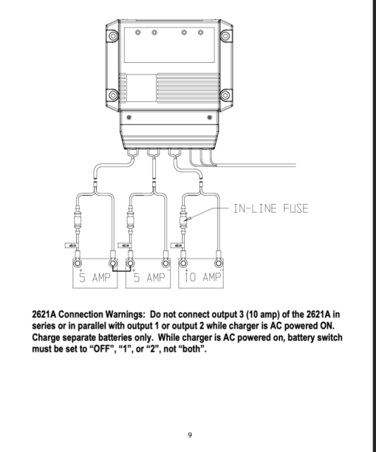

[quote="C-Wolfe"]... So here is my question, can I use the 10 Amps on one of the start battery and connect both of the 5 amps on the other battery?.../quote]
You have to check the manual to see if this is ok. Some chargers all this, some may not. Another thing to check, is that if you only have one of the 5 amp outputs connected (and the other is unused), will the 5 amp charger put out 10 amps? Again, some chargers will.
Thanks, I’ll look into this. There is 2 set of indicator light so you might be right about the charger putting out 10 amps if only one of the 5 is use.
Edit: A quick search show that I might be able to use the two 5 amps together for a 10 amps charge profile. but not the 10 with either of the 5. My model is Guest 2621A

From the online owner manual, it mention not to connect #3 with 1 or 2 but no mention of connecting 1 and 2 together., but that’s kinda what the picture shows.

The manual is confusing, but for the 3 bank charger (2621) The diagram is for :
Diagram 3. 2621A (5/5/10 Amps) used with 2 12V Batteries in series for a 24 V
system, and 1 other 12V battery.
This would be a common use with a boat which has a trolling motor, or even (very rarely) for a Hatteras which used a 24 volt system. (not be a good choice because the battery banks are much larger in the Hatteras)
The wiring for 3 separate batteries is the first diagram. 5/5/10 amps. It does not address the two 5 amps in parallel.

Yes, you are correct, the manual has the more standard 3 bank set up and this one for a single 12 volt bank and 2 X 12 volt in series for a 24 volt system. And as I said earlier, no connecting the 10 amps with the 5, but no mention of connecting both 5 together, like what you are doing in your garage setup. I just wanted that confirmation that it was going to work and not damage anything. You are also correct about the monitor light. Thanks

I did a bit of testing on the Guest charger, hooking up Both 5 amps double the charge to my battery. I was getting about 3.5 amps out of a single output wire and 7 amps once connect together. My battery was full but getting drain through the dc/dc charger, I might get a higher charge if battery is lower, although I was getting a full 10 amps on the other battery out of the 3rd output wire so it might be as good as it get, I can live with that for now.
