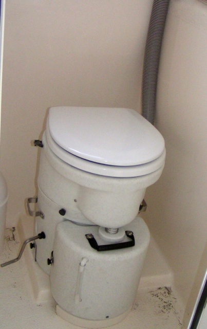

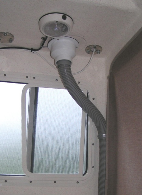

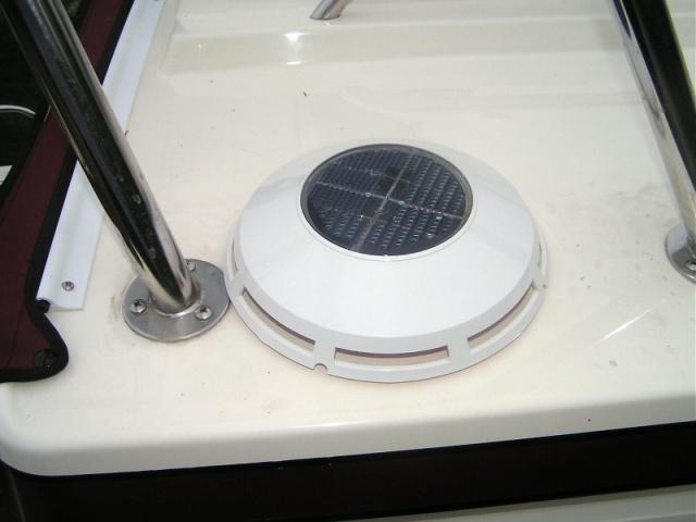

Indeed, the standard marine head is stinky and tends to spew ##!** all over owners sooner or later when something gets clogged. The stories about that here are legion. The fresh water flush tank under models are certainly better, but the problem is, sooner or later you have to pump it out, and it just might be full when a pump out is not convenient. And as to odor, ask David on Anna Leigh when we are side by side at the dock which one smells worse, our Airhead or his marine toilet. Not a contest really.
The Airhead design has a liquid tank and a solid container. It composts very well, we only need to empty the solids container about once a year. A year's worth of composted "poo" looks like soil, and is perhaps 3 gallons in volume. I probably would not dig it in to the vegetable garden but I would have no qualms about digging it in to a flower bed. The liquid tank of course we empty overboard when it is full, but actually urine is sanitary, and it is not a problem.
Getting an Airhead from the git-go was a great choice for us. I don't know how anybody could have an opinion about it without knowing anything about it...

Don't know about that, we told the factory to leave out the marine head when they were building Daydream in 2005, which they did and gave us a credit. We bought and installed the Airhead ourselves after taking delivery. The only other C-Dory with an Airhead we knew of before reading the prior post was a 25 Cruise Ship that Marc Grove had in rental service at Wefings some years back, I suppose that must have been a retrofit, but you might want to PM Wefings about that. One recommendation I would have is to up the size of the fan and run it off a dedicated small battery like a motorcycle battery with a solar panel to keep the charge up. That fan runs 24/7, and it is OK if you are on shore power all the time, but if for any reason you lose charging and the fan keeps running, even at 80ma it is going to run the house battery down. That has happened to us, and I am eyeballing the Harbor Freight 15 watt panel to dedicate to the Airhead fan. Also I think a larger fan would promote even better composting.
