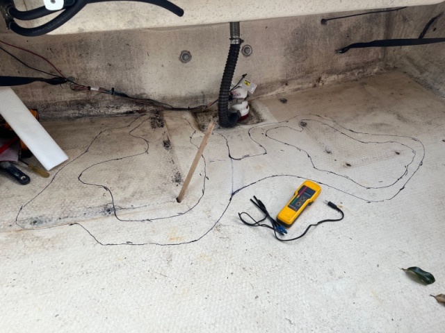

I have a couple of questions. I have an old Protimeter Surveymaster that I paid over $500 for 24 years ago. I have long probes for it so I was able to survey the sole without penetration as well as drill test holes and verify what my survey readings meant. I mapped out where the sole is wet as pictured. Outside the outer survey line is where moisture readings dip below 20% and inside the inner line is where they climb above 30%.
The screw holes were previously half-ass repaired. But before about 2 years ago the boat was kept mostly covered so I don't think water penetration was a big deal. I am guessing most of the saturation is more recent and that is why there isn't more rot or delamination. I drilled out the old repairs/holes to half inch and on all but one the balsa seems sound and has no discoloration.
Here are my questions:
1. I saw that several people have drilled spaced holes to allow the core to dry out. I am thinking to do this using 1/4" holes drilled most of the way through and then over the next month or more run a heater or fan under the transom. I was thinking of spacing these holes 3" apart, as that is the outer spacing limit for using my moisture meter probes to verify things have dried out. Is that enough to get it to dry or do I need to drill larger or more holes?
2. One of the 1/2" holes has some rot in it and in trying to clean it out it seems to extend anywhere from 1/2" to 1+" around the hole. I would like to actually enlarge the hole so that I can make sure and clean it out well. Just curious what is the maximum size epoxy patch one would want to do before actually doing a core patch and glassing the repair?
3. In drilling out the old holes which had been half ass repaired with epoxy I noticed that some of the balsa that came out was sticky, like it was saturated with uncured epoxy or hardener or something. Just curious if someone might know what that is from?

If that area is all that you intend to repair I would just cut it out and re core and re glass. It's mostly under the tanks so you wont really see the patch job. Its a small area so not too big of a job. Could be done in less time that drying it.
1) Seems reasonable to me, might take a while to dry
2)I don't see a problem with doing a large patch like that but I would probably use thickened epoxy and probably still glass over the top. You would probably need to pour the epoxy in over a few different pours because it would definetely get too hot as a single plug.
3) Dont know what that might be but I would get it out of there

If this were my project I would be more inclined to cut out a rectangular area to 1, be able to assess the entire problem as to weather you have rot and how extensive it is and 2, it will give you good access to dry it out and replace any balsa if required.
I'm not a fan of drilling holes and putting a heater under the hull because in order to dry it out you're going to want to pass air across the holes to carry the moisture away. The moisture trapped inside the hull has nowhere to go and by heating it up makes a good mold environment. Maybe larger holes would help. But again I would cut out a patch and if everything seems sound put a fan on it for a week or so until you get good moisture readings, then fiberglass the patch back in. This will also give you an opportunity to address the existing holes to drill them out oversized and epoxy them for the new mounting screws for the tanks. Good luck.

Thanks for all the input. Looks like I will probably just be cutting it out and patching it eventually (before summer). I am going to be treating the transom penetrations as well so I think I will dismount the main and kicker before cutting up the sole to reduce any chance of deflection (I have a bunk trailer and the transom is fully supported on the bunks but still....).
I have scrap 1/2" Corian Solid Surface materials (it is actually Formica brand) I think I'll do an experiment to see how well it epoxies to the sole skin material. May use that for the cleats and glue them in. It supposedly does fine with UV exposure and is used in outdoor kitchens. I have had some installed in full sun for 2 years now and it seems fine. If not that I really like Shad's solution with the epoxied studs.

I agree with the re-coring. The try to dry out with multiple holes in the hull is iffy. I have been involved with drying out hull cores for many years (also osmosis damage--in some boats to failure of the hull. I have seen a hull take over a year, with hot pads and vacuum--to the end result--15 years later the core was still dry. But the repair cost over $50,000.
