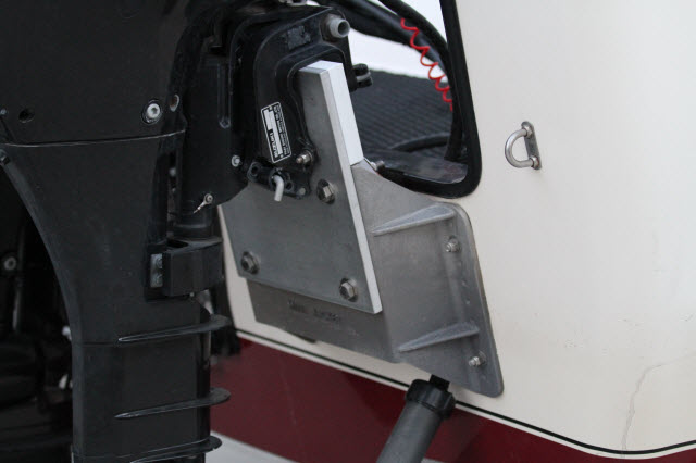

This stops the rooster tail
http://www.c-brats.com/albums/Upgrades/IMG_0142.jpg

To keep my kicker from dragging while it is tipped up, I built a mount that changed the mount angle to vertical. See a photo in my album, Nowhere Fast.
