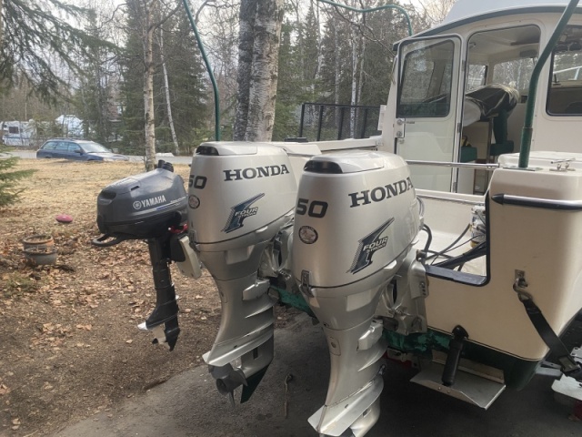

tsturm
Posts: 1165
City/Region: Soldotna
Vessel Name: JMR TOO
Photos: JMR-TOO
PostPosted: Mon Dec 23, 2024 8:23 pm    Post subject: Reply with quote
BigSwede wrote:
colbysmith wrote:
If considering a small kicker only as an emergency backup, then you probably should have a separate fuel source.
Why? I guess I can see that contaminated fuel that took out your main would also be a problem for your kicker, but on the flip side having access to the main tanks would allow for a longer run for the kicker to get home if necessary. Just curious on your thoughts here.
Fuel / water separator with extra filters on board.
