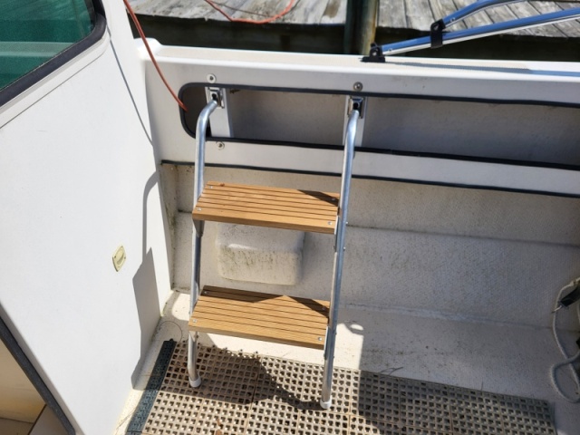

We installed these Garelick steps. I had to put in a couple of supports since the height isn't exactly right. I got a second set of mounts and put supports on the other side of the cockpit, too, so that we can move them to whatever side we need.
Gerhard

I like it. I may start looking for those.
Thanks to you and all who replied.
