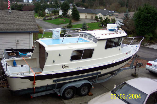

Old Republic came from the great lakes area to Washington and got a complete rebuild. New motors, Changed the deck layout, redid the cabin some. It looked and handled great. Once it got sold I don't know where it went. Its like the 27 pilot house that went to Alaska and was never seen again. That one had a raised pilot house then dropped down to a large cabin but had a small back deck. was I/O powered with a v6? . Guy that worked for the state department security bought it here in Washington and then cruised it to Alaska.

http://www.c-brats.com/albums/Aiviq/27_pilothouse.jpg
Does anyone know what happened to this boat?
