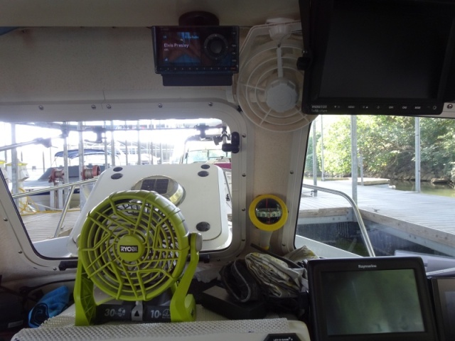

On the subject of fans--and they are as important in the PNW as in Florida".We have at least 4 Caframo fans through out the 22's and 25's. One on each side of the bunk to blow on the person in the bunk--one by the helm center and one aft blowing over the aft dinette seat. We also had a "Vantastic" RV fan over the forward hatch, similar to bathroom fans in RVs--usually 3 speeds, 5/8" dowel rods to rest the fan on--with flat places so they don't roll on the edges of the hatch--this is external to the screen or shade over the V berth hatch. The ones over the bunks have remote controls, so easy to reach in the bunk or from external, plus lights in the center.
We also carried a Ryobi fan which had its own stand, and would run all night on the same 4 or 6 amp battery. We would often put this by the opening window in the windshield when not using the AC. Also in my album are a number of tricks to using the fan: a block and tackle system to lift it in place, wooden runners, handles on each side, pool noodles and a skirt to seal the opening around the window.
Below is the Ryobi fan, Camfro fan

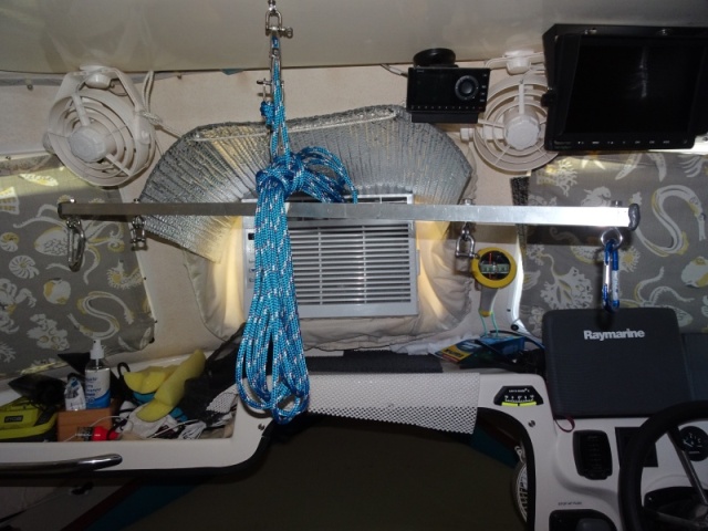

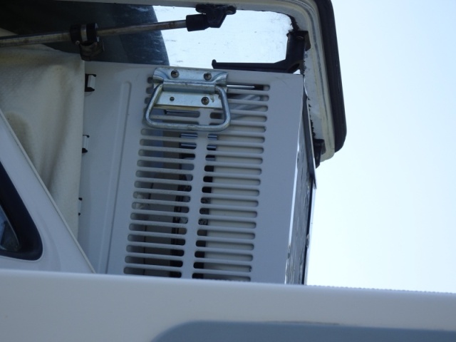

Below is the spreader bar and block and tackle to raise the AC from under the bunk, to the window--hooking into the D handles in the 3rd photo. Also skirt around the AC.
handles on the window AC unit.
Windows have the reflectix Mylar/bubble wrap and black out shades to help heat gain or loss through the windows.
