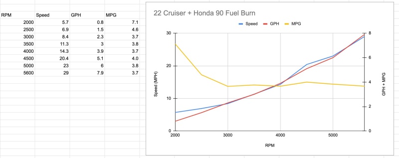

Ahoy! New 22 cruiser owner here. Curious about where the boat operates most efficiently, one of the first mods I did was to add a GFS10 fuel flow sensor to the Garmin MFD that came with the boat. My girlfriend and I did about 50 miles today and I was able to run an experiment where I collected fuel flow data at various RPMs/Speed. Each data point was collected with the motor and tabs trimmed for highest speed at that RPM. I first trimmed motor with permatrim plate for highest speed, then played with trim tabs. I found that the boat actually went a little faster with about 1/2 bow down trim on tabs. They seemed to "lift" the stern some and help the boat ride flat on the flat section of the hull.
I entered this data into a spreadsheet, calculated MPG, and then plotted Speed, Burn Rate and MPG vs. RPM hoping to find a speed with the best efficiency. Obviously, slower should be better but I was curious to see if there was a dip in efficiency at semi-planing speeds (where you throw the biggest wake). Surprisingly, fuel economy seemed pretty consistent at around 4 MPGs from about 8mph all the way up to full throttle around 30mph.
I hope some of you find this interesting or helpful. Has anyone else measured similar results?
Now if I could only be smart enough to figure out how to access and upload photos to my album on here... Here's a link to the FB post I made on the Cdory owners group with a picture of the plot and data...

SurfDory, looked at your FB link numbers for fuel economy. Do you have a number for fuel economy at 1500 rpm? I would think that your fuel economy mpg would be quite a bit higher at an even slower speed. Being able to slowboat and save fuel is a great benefit of owning a C-Dory!

8 mph is probably one of the worst speeds you can go MPG-wise while still not on step for fuel economy. You're probably pushing a big bow wave forward (displacing a lot of water), and the boat is barely not able to ride over it and plane at this speed. Here are my numbers for a new Honda 100 on a moderately-loaded CD22. Note that mpg is pretty high, almost 10 mpg until we get close to hull speed of 7.3 mph, where it drops. In his long journey in Hudson Bay (Arctic Solitare book), Paul Souders typically cruised at 5 mph or less since he needed to increase the distances he could go between fueling in these remote areas. 5 mph should be about as good as you can get, and much after that you start of push more water instead of boat. As you get onto step, mpg increases a little from 4.6 to 5.5 mpg, and then at higher speeds, you get a small drop with higher speeds. 31 mph was not WOT for this motor, but was getting a little scary for my boat, so I don't think I will push it to WOT very often, if ever. Most of my boating is in kayaks, canoes and sailboats, so I have little need for speed, but I love high MPG.

On Rob's data, I suspect that the boat went on a plane somewhere between 8.4 mph and 12.9 mph. Many run their boats at about 17mph and find that an excellent "goldilocks" speed. It is also important to differentiate statute miles per hour Vs nautical miles per hour. (same for the mileage). Although there are many ways of writing the nautical mph, often it is noted as "knots per hour" or knmph vs smph or statute miles per hour. One might ask why many do not use the nautical miles per hour. On the ICWs and Rivers the mileage is in statute miles. At sea and offshore, the mileage distant measurement is usually in nautical miles.

PostPosted: Mon Aug 12, 2024 5:38 pm    Post subject: Reply with quote
This is the OP's chart from FB. BTW, the flattening of the curve is pretty much what I've found on both my 22 and 25. Best fuel flow is at hull speed or slower. After that, the fuel flow is pretty much the same. Current can play havoc with numbers. Colby

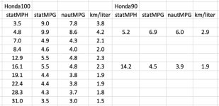

PostPosted: Tue Aug 13, 2024 11:27 am    Post subject: Reply with quote
Foggy wrote:
Keep in mind the data given is no more than the result with a particular boat
at a particular time (or average times) in a particular place.
Because you may have the same make/model boat and engine as another who
posts their data does not signify your boat will do the same. Why?
All of what Foggy says is incredibly true. The reasons I was able to post the data I did was partly because I repowered from an 2003, high-hours carbureted Honda 90 to a brand new Honda 100 that had integrated NMEA 2000. The Honda 100 is lighter, but not significantly.
I also removed two things...a heavy starboard 9.9 kicker with tilt/trim/etc. that maybe put an extra 100 lb on the starbord stern. I also had an electric trolling motor mounted above the antiventillation plate on the Honda 90. All of these made my combination starboard and stern heavy unless I loaded up the front and port, which I did for trim and tilt. In the new combination, I changed to a bow-mounted electric trolling motor. The stern rides higher.
Also note that my MPG were statute miles, not nautical miles. I should probably have posted both.
