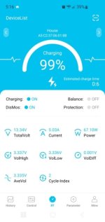

I believe Bob also asked about the info the Li app gives. I can get a screenshot later, but it tells the basics:
State of charge
Total battery voltage
Individual cell voltage
Current in/out
Power in Watts
Volt high
Volt low
Volt delta
Average volts
Battery cycles
Also via the app, the battery can be turned on or off meaning I can remove it from the system entirely. I can also have it in the system providing power, but turn off the ability to charge.
It also shows trends of charge history in volts and amps.

Here's a screenshot of the app that controls the built in shunt in the Viaer Chinese battery from Amazon. It works fine, but not nearly as smooth as the Victron app.

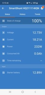

Here is a screenshot of the Victron app that controls the Smartshunt in my trolling motor battery bank. Here, it is in the charge config by showing 12 volts charge at the top. Once it's done charging, it automatically goes to 36 volt series mode through the Trollbridge 36.
