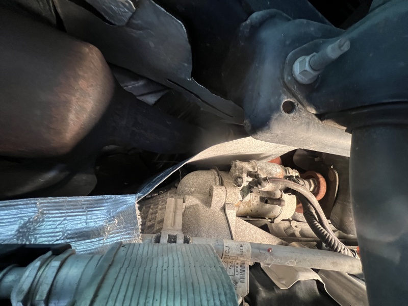

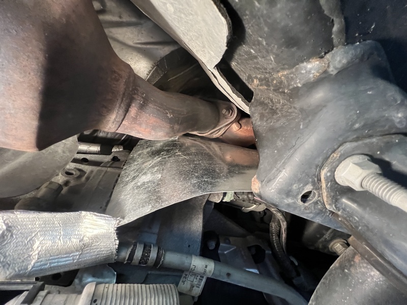

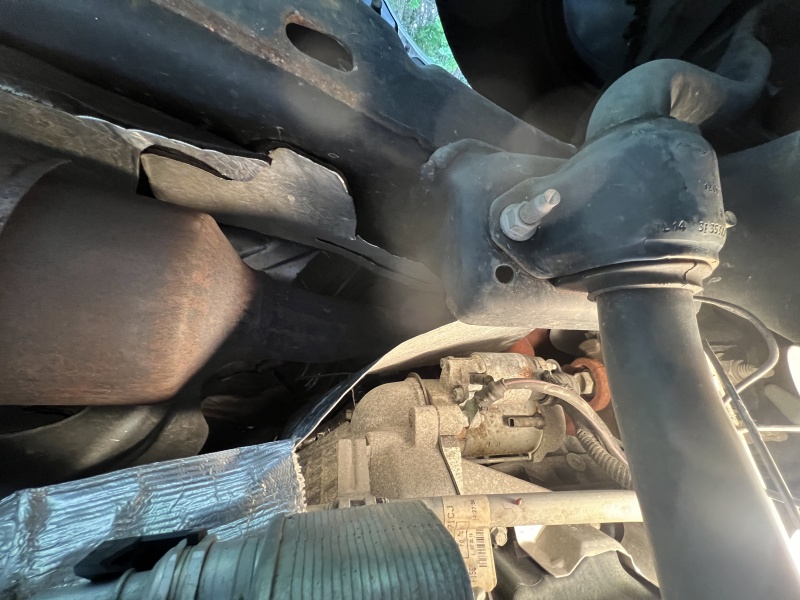

Made and installed a heat shield as per that youtube link. Hopefully this will resolve the problem.
These photos are while laying on the ground looking up at the starter and exhaust manifold.
