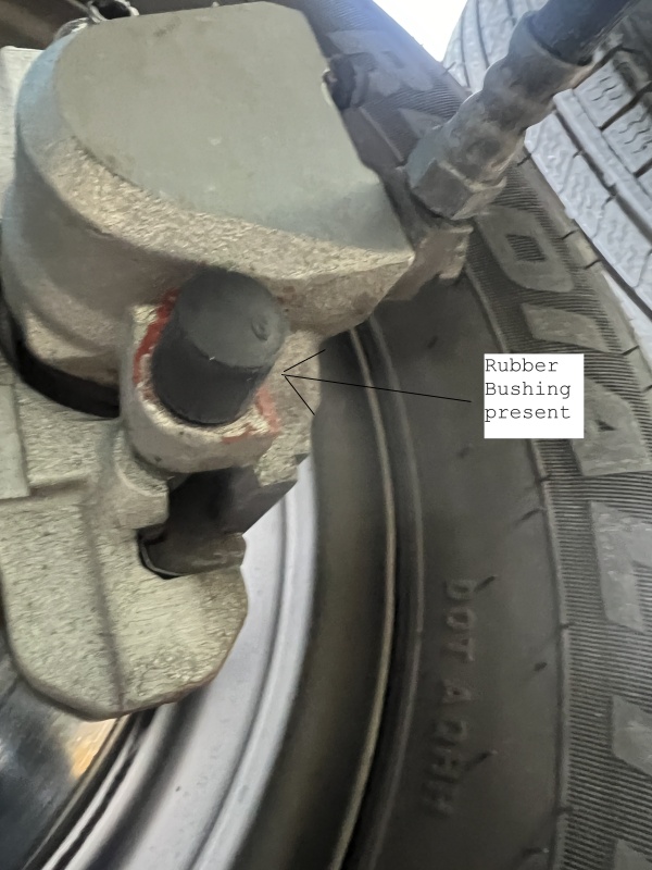

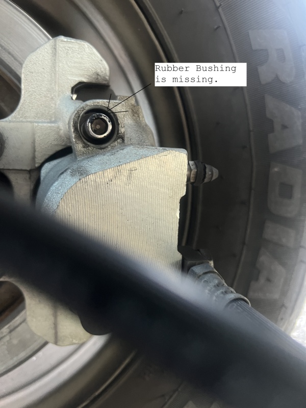

Ok, I swear I'm going back to all electric sooner than later. I'm still having issues with the disc brake calipers on my trailer. The issue seems to be the rubber bushing that the slider pin goes into, are coming out somewhere while driving down the road.
This is a picture of what they look like:
And this is a picture of one missing:
Fortunately, I'm catching them before the pin fails from the caliper bouncing around it. And I purchased some extra bushings and caps. I've had two, and again on the starboard side of the trailer, come out and go missing after 1000 miles of driving, and then the next one after another 500 miles. That seems to be about when they come out, 1000-1500 miles. I've got the brakes set to medium on my F150's controller, and I"m not braking hard or riding the brakes. I'm open to suggestions. But if I have to buy more expensive calipers, right now I can change over to fully electric for what a couple of the current calipers cost! Mad Colby

Hey Steve,
The bushing is the piece that goes inside the hole that the slider pin slides through. Then there is a cap on top of it. I don't think they are melting away. My suspicion is that since the rubber bushing is rather tight around the pin, and the pins are not greased, that when the pin moves, it is pushing the bushing out. I will probably contact Loadrite, but I doubt they will have an answer. I really need to get a hold of Dexter, and see what they say. I'm thinking I have a couple options, other than spending more money on the calipers that Alain and Tom have. (It's a helluva lot cheaper to convert to all electric, than to replace the four calipers!!!) I will try greasing the pins with something that does not degrade the rubber bushings, or see if I can fabricate some brass bushings. What I don't understand is that these calipers are pretty common. And nobody else seems to be having problems with them... Colby

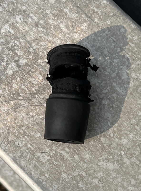

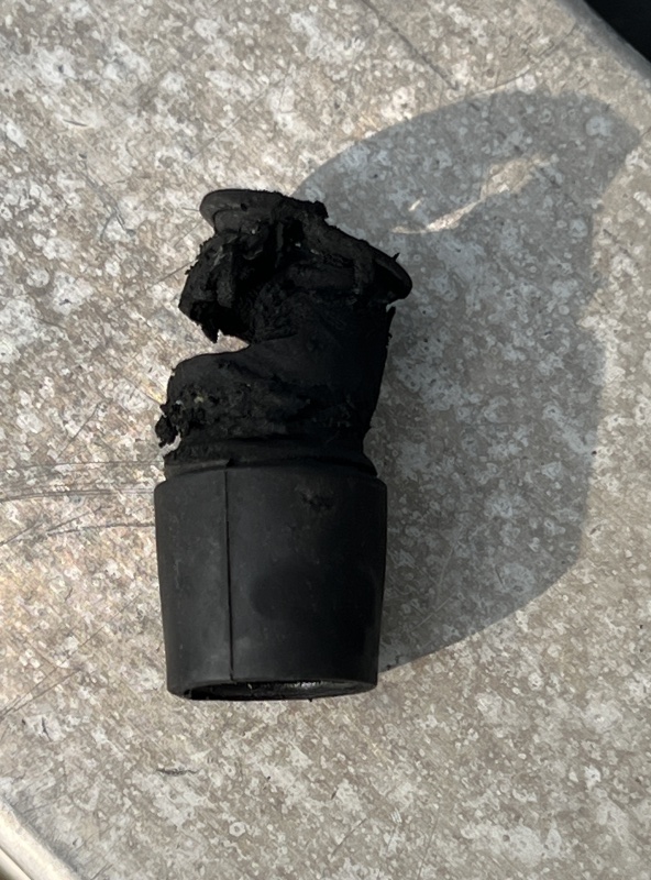

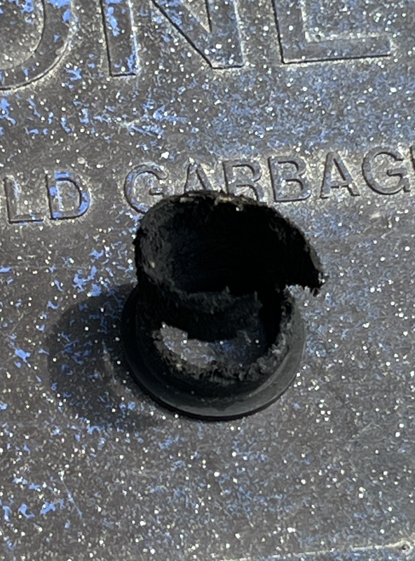

Well, here we go again.
My boat trailer has EOH disc brakes. The calipers have a rubber bushing, or boot, that the slider pin goes through. (Part number 33305 if that matters.) After about 5000 miles these rubber boots start to disintegrate and/or disappear. If I don’t catch it in time, this will cause the slider pin to eventually break off or vibrate out, then allowing the caliper to fall off. Surprisingly these calipers came from the manufacturer with dry slider pins. I’ve found the rubber boots will last longer if I grease the slider pins before long trips. The rear axle seems to have more of an issue with this. After my last long (5000 miles) trip, I found both rubber boots missing on one rear brake and both starting to disintegrate on the other rear brake. Why? I suspect heat is part of the problem.
Above was my post on facebook. I'm convinced now that the rubber boots are not holding up to the heat. If you look close at the boots, they appear to be a heat factor destroying them. The more expensive calipers Tom and Alain have mentioned in the past run almost $200. The ones I'm currently using are around $165. I can replace all four brakes with new drums and electric brakes for a little more than the cost of two calipers. I have had a suggestion to see if I can find some silicone boots, or something that is more heat resistant. It seems I only have an issue with the boots after several thousand miles, and that usually after going over one or several mountain passes several times. I tend to use engine braking, but still need to apply additional braking. I don't believe I am using excessive braking, but none the less, the brakes are going to get hot. I never heard back from Dexter earlier. I'm still trying to solve the problem, and just wanted to bring it back up again. Adding your brake calipers to your checklist for trailering is probably worthwhile. Here are some photos of the caliper slider pin boots that were partially destroyed, but still in their seat.
