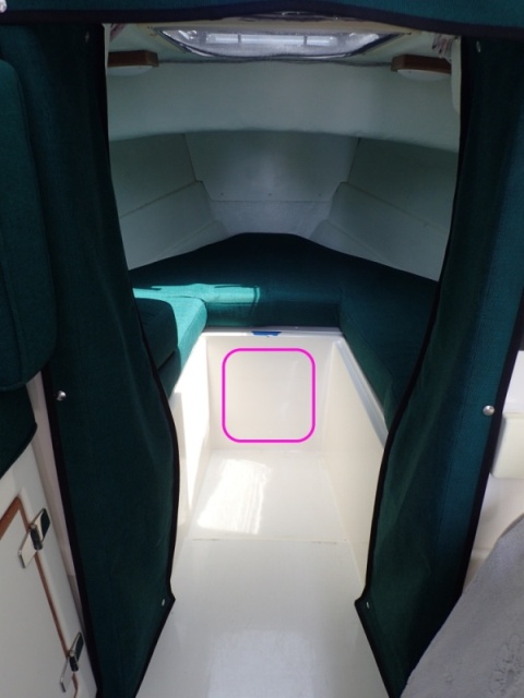

I used a piece of 1/4" PVC sheet to close the anchor locker off in my 22. It is held in place with screws to allow for maintenance access. You can see it in the background of this photo.

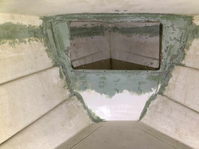

I'm in the process of enclosing my anchor locker with a hatch. See my album entitled Anchor Locker for the only photo I have so far. My boat work is on hold for another month while I tend to other projects, but the photo should give you a general idea of what I'm doing. I cut a frame out of 1/8" plywood to hold a Tempress 13x23 cam hatch. I covered both sides with a layer of 1708 fiberglass embedded in epoxy resin and then epoxied the frame to the hull. The green stuff is fairing compund. It will all look better when painted and the hatch is installed.
