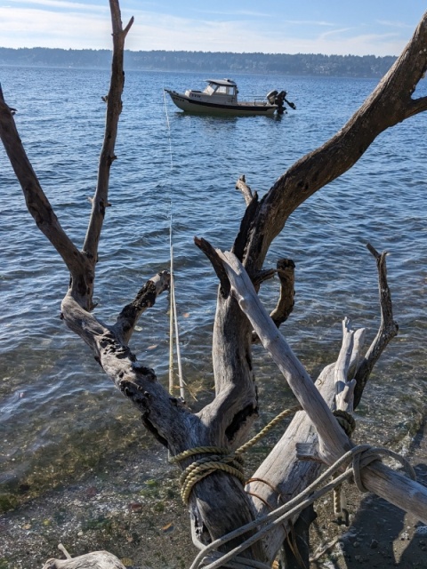

Hello, just wanted to share a technique that I used the other day with significant success (more on that in a minute), which I think solves two dilemmas often faced by Dory people: swing and shore accessibility.
I inadvertently tested this out in a ~20mph onshore winds overnight and it worked really well. Video link here: https://photos.app.goo.gl/g9UrvCcsSsTzJnid6
Caveat: This technique is new to me, and I don't see it mentioned prominently on the forums, I'm sure others* have used something like it. There's nothing truly "new" under the sun!
Basically the technique is this: Set an anchor offshore before beaching, then use it to haul your vessel back offshore after, but trailing a bow line, so that you end up in a zero-swing double moor.
I've attached a basic diagram, and will drop the steps in a comment.
The difference between this and a standard shore tie is the ground tackle, and the fact that you are able to bring your boat back off the beach.
Sailors or those with more anchoring experience will recognize this as a modified Bahamian Moor.
*I believe that Marco Flamingo has used a similar technique except with an elasticized section of rode, which 'springs' his boat back off the shore.

The specifics:
(1) The anchor is readied on a bight - the rode is passed through a shackle (or ideally a swivel) on the anchor, then both ends are made fast.
(2) Approaching the beaching site, just outside the intertidal zone, the anchor is laid off the stern of the vessel. Scope is paid out on both legs of the bight so that the rode trails astern (clear of the prop) as you continue ashore; The anchor is set by briefly halting the scope and powering-on, before continuing.
(3) At the beach, One end of the bight is taken ashore; the other is made fast to a bow cleat. A second rode is also made fast to the bow, and coil taken ashore.
(4) When ready, push the boat off and haul in the working end of the anchor bight. This hauls the boat back offshore. When the boat is hauled to proper scope (3:1 etc), make the anchor rode fast, then haul in the second rode until the boat is 'suspended' between the two points. Make the second anchor rode fast and crack a beer.
Obviously there are two 'issues': first, you need a lot of rope - two full length rodes, at least. This is because, when going ashore you will need to set your scope plus the distance to the shore, times two! On steep shores this is no problem, but in a flat bottom bay may be tricky. Second, you gave to carefully track your rode payout/haul-in, since you will have to verify your scope from shore.
I think this is best suited to 16 and 19-foot CD's, because they can use smaller rode, and thus comfortably carry more. Personally I am planning to set up a dedicated 300' spool of 3/8 on the stem rail specifically for this.

quote="colbysmith"]I'm not sure this provides any advantage to anchoring off the bow and stern tying to shore. Confused Except maybe in regards to current or wind direction hitting the boat abeam... Colby[/quote]
Well, the first big advantage is that in the situation you describe, you have to dingy ashore, whereas here you can beach, then haul the boat back offshore. If you're not carrying a dinghy, stern ties and all other anchor methods are off limits... unless you like to swim!
A second advantage is the one you note - it allows the boat to pivot to weather. I think this is a pretty big advantage, given how much water a boat anchored stern-to-weather can take over the stern (I read somewhere here that a dory was at one point sunk in this situation).
ssobol wrote:
The other issue I see is the boat getting hung up in the lines if the current or wind change direction.
My observation setting it up and watching it all afternoon was that with the motor up, The flat bottom actually slides perfectly over either rode. Which actually makes sense: consider that sailors (including myself) using Bahamian moors have no problem even though they have keels and rudders below. A sailboat can spin around a Bahamian moor all day with no issue being getting the rodes a bit twisted.
I have used a variation of this technique for many years for dinghies. I have a dedicated anchor chain/rope rode, and set this well out off the beach. At the end of this is a block with the "endless" shore line going to it. I usually tie the bow to the one end, and the other end to a stern cleat. This is especially good in high tidal ranges, so you can tie the boat well off the beach, and still get it back as the tide goes in or out. Length of each component depends on the anchoring depth.
I have also seen this, and was partly inspired by it! Again I think the difference (advantage) with setting both at the bow is that it presumably handles an onshore breeze much better. The 20 mph blow that came up when I was anchored out would have put quite a bit of water in the boat if she was held stern-to (and stern-down, no less).
I do not consider this as a Bahamian Mooring. The Bahamian Moor is two anchors at 180* and best utilized where the current or wind shifts regularly, and the boat is riding bow into wind or current most of the time. (except at high and low slack water). Having a swivel at the interphase of the two anchors, especially if the anchors have all chain rode. If not, as Foggy notes, you will have a lot of untangling to do.
I agree that this is not strictly a Bahamian moor, since as you note, it only uses one anchor, and substitutes a shore tie for the second. But the effect is exactly the same - suspending the bow of a vessel between two points, so that it swings within a boat length only and never pivots (backs) its anchor. And if you set an anchor ashore, which you certainly could, I think it definitely would qualify. But anyway, that's why I called it a 'modified' Bahamian!
I would note that from personal experience, tangling is actually not a huge deal. In crowded anchorages on my sailboat I'll set a Bahamian moor about half the time, because it takes almost no extra work and is fantastically secure. A swivel is nice but not strictly necessary, and all-chain is certainly not. If your boat spins, your rodes will twist, but only at the top. It's simple enough to undo - just free the bitter end of one rode and unwind it. I think after a particularly spinny night on my sailboat it took me ten minutes. CoolSmile

I agree with Foggy. A point that Salish_Explorer is missing is that Danforth anchors or any anchors are designed for a load pulling straight back in line with the shank of the anchor. If you side load--which his "technique" does, it side loads the anchor and will guarantee it will pull loose and drag or worse with significant load. A C Dory 16 or dinghy is not a significant load. 20 knots of breeze is just a good sailing breeze for some of us--not storm conditions. 50 to 60 knots of breeze, is significant.
I have more experience than I like anchoring in storm conditions; up to 90 knots of breeze on several occasions. (fortunately those two were in calm seas.). I have dove on the anchor rode and anchors in 90 knots of wind, to watch the dynamics. I have also had to deal with anchoring in winds up to 120 knots--fortunately not my boat--during a hurricane. This had to do with random anchors on a 60'
Schooner, anchored in our bayou, which was dragging all over the place and causing damage. During the eye of the storm, we boarded the boat, got power on and secured it to pilings where it was secure and not damaging any other boats.
Salish_Explorer mentions a sail boat, but no explanation of the size draft etc. Also if the outboard is fully up and out of the water, then the ropes of this type of moor will slide right under the boat. If the outboard is down, there is a fin keel, or spade rudder, then big trouble as the rode fouls these appendages.
Just because you tie a line to the stern, does not mean that there is any load on the stern, the boat can still ride to the bow. All of this depends on how one configures the lines.
On my inflatables which I have moored this way, the bow attachment is a line eye spliced with a thimble and a shackle hiding this to the metal bow eye. All of this is to avoid chafe. How is chafe handled on your 16' C Dory?
You equate the C Dory 19 to the 16, it is more relevant to the 22, in that the 19 is basically a 22 with 3 feet of length removed. The pilot house windage, and profile is similar.
Anyway--your technique is not unique, but one does need to be sure his boat is safe.
Thanks for the thought provoking thread.
Salish_Explorer
Joined: 23 Sep 2023
Posts: 41
City/Region: Kingston
Photos: Salish Explorer
PostPosted: Thu Oct 19, 2023 12:58 am    Post subject: Reply with quote
That's good to know.
As to chafe, my experience is that for single-night anchors in moderate conditions on relatively light boats it isn't really an issue. I've used adjustable bridles and sections of hose around the line on larger boats, but all that seems a bit overkill here. The rope path is quite smooth, and even after the rough night in the video above, there was no evident wear.
Have you experienced otherwise?
I don't mean to be contradictory, but I Believe it's physically impossible to side load an anchor from a single point of attachment.
Two (or three or twenty) simultaneous forces applied to a single point inherently sum to a single vector/force. Side-loading would occur if the anchor was held in place and loaded at an angle - but since a marine anchor is by definition free to reorient, that condition can't occur - even if a second or third line of pull is added, the anchor can simply pivot into line with the sum vector.
I am not an engineer, but Think about a carabiner on the end of a rope: If two people pull on the carabiner in different directions - say 30 degrees apart - they don't side-load the rope.
From a physics perspective, I think the actual concern is that when the rode is fed through the anchor shackle, the anchor effectively becomes a pulley, which can as much as double the force placed on it.
However, adding a vector along the sea-bed (in addition to the 30-ish degree angle of the surface-leg) creates a sum vector that is more parallel to the sea-bed than the vector of the surface-leg alone - ie, it shifts the line of pull closer to the anchor's axis of maximum strength, not further away from it.
I'll be honest and say that I don't know if that's enough, in a truly heavy weather situation, to fully balance out the additional force applied. However in a moderate weather situation it worked extremely well.
As to tangling - you can argue from theory, but I'm speaking from significant practical experience with dual moors when I say it is almost never issue, even without a bridal, even with a fin keel and spade rudder. This is because on any two-anchor setup, as you swing into line you automatically unload the downwind rode, which (with 3-strand) sinks, forming a catenary and allowing the swinging keel to clear. I'm not saying it doesn't happen, but in my experience even on fin-keeled boats it's fairly rare.
If there are any engineers on the forum I certainly would be very happy to be proved wrong on any of this (so long as I can learn something in the process Laughing).
