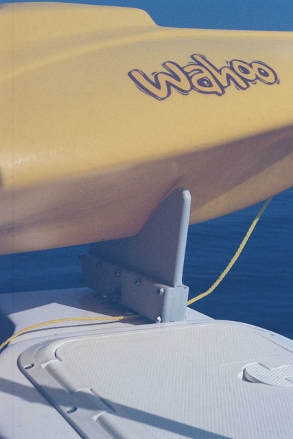

I've got a little, 11' I think, sit-on kayak that we take occasionally. I made up a couple of Starboard mounts that slide over the stern cleats. The kayak sits across the stern on these cradles and is bungied down for security under way.
It works very well and keeps the kayak out of the way for most other activities. Since I used it last, however, I installed twin stern rails that may work just as well as the cradles. I just haven't had occasion to try it yet.

Moose, great idea and a pic is always so much more helpful for me, thanks! Seems like a handy storage space while cruising. Mines a sit-on-top also and I can see it being a storage platform while stored there also.
