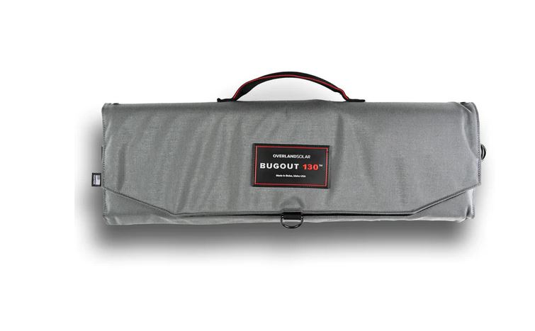

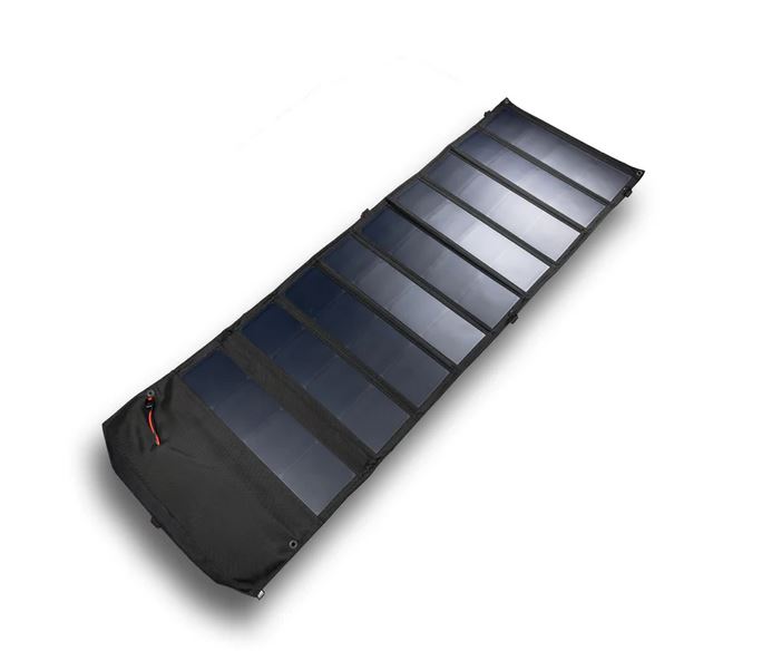

What I ended up with was 2 130 watt panels from Overland Solar not cheap but they fold up the most compact. I use them for offroad and the boat.

The Overland setup looks appealing.

Jody, I think the Overland would be out of my price range. Gary, I've been looking at their 200 watt panel that comes with a 40 amp controller. Just not sure what size that is and if it would store easily. I think I've also seen some of their rigid units that might fold up to something doable as well. Just not sure how well a rigid panel would mount on the boat. Not even sure where I'd mount it. Sometimes my roof is empty. Other times it has a bike rack with bikes, or a kayak rack with kayaks. Both of these racks mount to the hand rails and then sit perpendicular on top the roof. I could place the solar panel on my bimini, but it's not always up... Colby

Your examples are why the Overland panel would be great to have.
I don't like the price either though.
