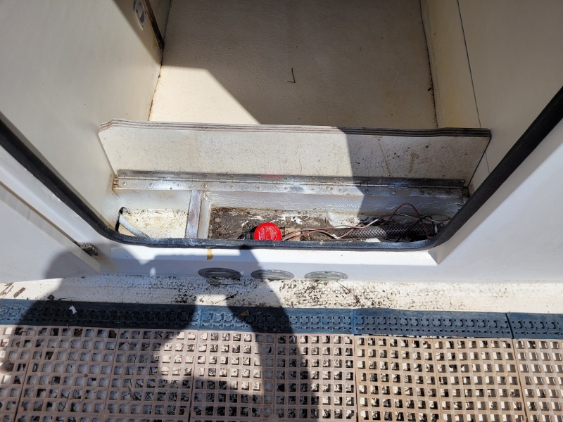

We have a 1998 22' cruiser with the little step that houses a bilge pump at the door where you enter the cabin. There are three grates that allow water from the cockpit to get in there so the bilge pump can pump it out. However, we keep getting water seeping under the forward wall of that little step compartment into the cabin, and if we have lots of rain, there is quite a bit of water in the cabin.
OK, I thought well, the forward wall must not be sealed well, so I put a layer of fiberglass on all sides and onto the bottom of the little compartment and said that should fix it. Wrong. So, I hit the whole compartment with FlexSeal...still seeps water. I thought, OK, the pump must not be coming on fast enough during a hard rain, so maybe the water is building up enough to go through the holes where the hoses go through...so sealed them...nope.
Today I ran a hose in the cockpit and water seeped in. I put a towel on the outside of the little grates to keep cockpit water from getting in to the bilge pump box and just put some water in the box...and sure enough, the water starts seeping under the inside wall of that box and into the cockpit.
I am about to lose my mind chasing this down. Any ideas?
Thanks!
Gerhard

In the back, I am not following the grates? Please a photo of these. What type of floor in the cockpit: just the inner hull, nothing on top of it. The two section removable flush floor--tapers from about 1 1/4" ib on the centerline forward, and to an edge outer and in the back.

[/url]

Yeah, that's the pic of how mine is set up. The water is not coming from forward or from rub rails or the water tank. It is definitey coming from the cockpit or that collection box, as I filled it with a hose and water started seeping in to the cabin under the back wall of that box...which should be impossible at this point since I have fiberglassed it. I think my next option is to pull everything out of there and just redo that whole box.
I agree. I would make the new box so that at least inside the box is fiberglass, and glassed into the hull bottom. I would use epoxy resin and saturate the wood.
Bed the box into cabosil on its bottom, then tab in on both sides of the walls 0f the box.

Well, I may have found it. I found a crack in a piece of fiberglass tabbing on the bottom of the box. I have suspected that the water was finding its way under the box somehow and this fits that theory. I temporarily sealed it up and if that stops the water intrusion, then I'll do a proper repair.
Thanks for all the ideas and think this issue is unique to our boat so probably won't help others even if this is the fix.
