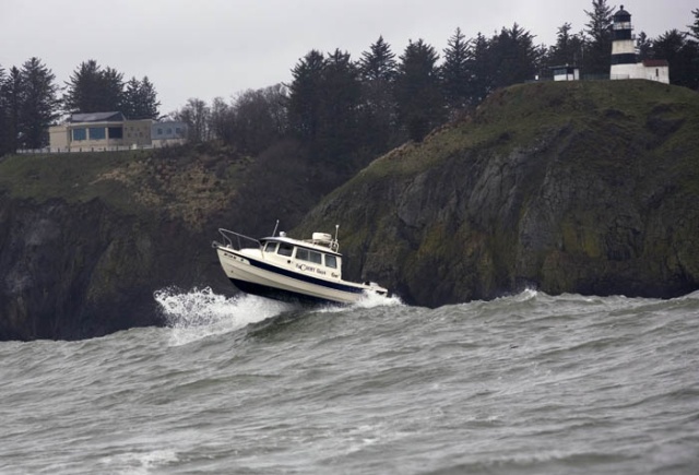

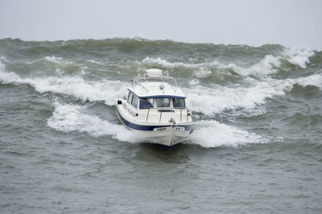

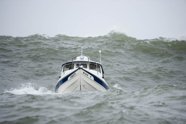

Check this out:
Bratwurst
Joined: 05 Sep 2010
Posts: 3
PostPosted: Sun Sep 05, 2010 5:17 pm    Post subject: Reply with quote
Yep, those are the pictures that first got me interested in the C-Dory. This http://www.c-brats.com/viewtopic.php?t=14389 is the ad that got my juices flowing.

PostPosted: Sun Sep 05, 2010 9:20 pm    Post subject: Reply with quote
heavy ground swells there with a telephoto lense - - a real test would show chop waves with all that - that is what will get ya, not the big swells so much. But to harmonize with the topic a little - i like the observation about the boats sliding rather than broaching - that i can vouch for! that is probably the best defense a c-dory has going over the big bruiser boats - that slip rather than the hook that can topple ya!
i have the old classic 22 - personally i think and feel she runs best beam-to in swells and chop! just amazes me!
