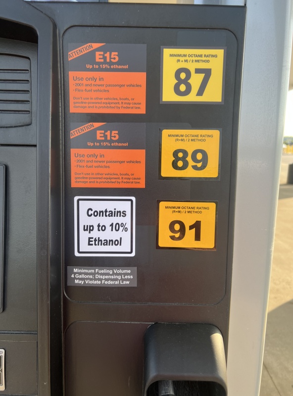

Well *&(^%$(*&@#! Put 80 gallons of gas in C-Traveler today at a Love's station in St. Cloud, MN, for $3.19/gal, minus another .10/gal with the app. Then saw the side stickers closer:
Makes me wonder if all Love's stations are running E15 in their lower octane fuels? (I fueled up at a Loves in Oregon between the California Delta and PNW trips and don't remember seeing any E15 stickers at the pump...at least conspicuous stickers... But I did burn most of that up within the month.)
Ok, I regularly run 10% ethanol in my boat most the summer, and have not had any problems doing so. (And don't think just because you fill up at the local marina, you're not getting E10! Many marinas won't tell you unless you ask, but many can only get that blend.) Guess now I know how Love's is getting away with their .10 off and cheaper prices. They are selling E15 and not making it well known. (I also noticed some stations selling Biodiesel rather than regular diesel. Not sure how the Webasto would like that...)
So for the chemical engineers among us, any suggestions or advice? (Or can you take my anxiety away about any damage that E15 could do in this one instance?). As soon as I get home tomorrow, I'll put some Marine StaBill 360 in the tank. I will be burning most of the gas out in July up at Isle Royale. So it won't stay in the tank more than about 6 weeks. Looks like my stops at Love's to fill the boat is done! But is there really any guarantee that even the E10 isn't a higher concentration than that? Colby

Taking Peter and Mikes (PM) suggestions to remove some of the fuel and then add pure gas (no ethanol) to dilute it, I'm pulling 30 gallons out, and then adding some "recreational fuel", (91 octane, no ethanol) from our local Kwik Trip gas stations. (For those wondering how I get the fuel out, I have a little inline electric pump contraption I put together that connects to my main fuel filter at the kicker connection. I use this to pump fuel out at the end of the year, and also to refill my generator from the little aux tank I have in my bilge with no ethanol gas) I did call the Love's I got the fuel from and spoke with the manager. She said they just switched to the E15 this week. Probably explains why their prices dropped .10/gal the day before. I also wonder if this was a new shipment of E15, what was the real blend if it was mixed in with what was already in their ground tanks? I didn't notice any reduction in my F150's fuel mileage, that I filled 95% of it's tank with the same gas. (I have noticed reduced mileage when running E15 or E85, in the past.)
I do run the E10 all summer without issue. However, at the end of the year when I had the 22 (smaller fuel tanks), if I was leaving gas in it over the winter, I always did my last seasonal fill up with no ethanol fuel. With the 25 and it's 100g tank, I have been storing it empty over the winter. But run non-ethanol through the main and kicker while winterizing them.
