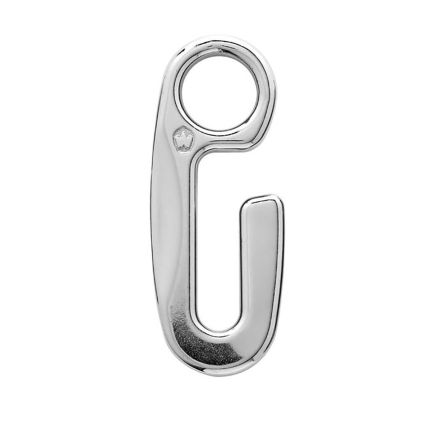

I should have commented on what we do with an all chain rode, and that I usually left a "belly" in the main rode, so it takes the load only if the snubbers are at their max load or break. Snubbers on that size boat had fire hose chafing gear attached where the rode went thru the hause pipe. (In this case, 6" x 4". oval bronze openings in the hull about a foot down from the gunnel forward.
With all chain rode, I have a permant thimble spliced with a shackle to a "chain hook" or "chain gripper plate"
Chain gripper plate
Chain Hook
