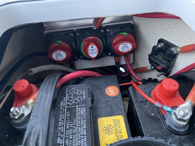

I went with a set up like this
I don't know if you have single or twin engines, I have twins. I have 2 batteries, one for each engine and pick one for the trip as my house, on a standard trip for me (2-4 days) I never touch the main selector switch. If I have too ( I did once but turn out the problem was the neutral switch) I can have either batterie start either engine, or also have either engine charge either batterie.
For the way I use my boat, this system works very good. I don't have to do too much monitoring since one battery should always be near 100%. I do have a digital volt meter with the on/off/on switch and even though I really like having it, I don't use it much.
