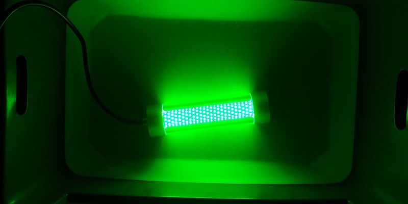

I added a second house battery for an underwater light for blackwater diving. I run it in parallel with the other house battery.

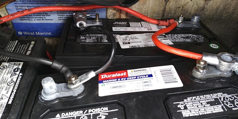

I have one Group 27 battery for starting, and two Group 29 batteries hooked in parallel for my house. Along with the original refrigerator, I also have an Engle Freezer, Webasto diesel heater, some LED lighting, some Carfrano fans and a Cpap (without humidifier). At night on anchor I will typically run the LED anchor light from dark until I get up an hour or so after daylight, my Cpap, the refrigerator, freezer, sometimes one fan, sometimes the Webasto, and one of the LED interior lights for an hour or two after sunset. 12-15 hours later, I'm rarely less than 73% on my Vectron battery meter. I run the regular lead acid batteries. I'm not sold the other types of batteries are any better than the lead acid when you consider cost, weight and charging methods. I don't have any solar panels, but sometimes think it would be nice to have solar available. I do have my Honda 2000 generator if need be. Personally, I think your trolling motor is going to be the big draw, and you'll probably want to charge your batteries after it's use. Cool Colby
