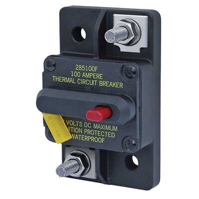

You could use a panel mount breaker like a Blue Sea System 285 series rated at 40 amps. They include a manual switch to open them and a reset lever. This could replace the 40 amp fuse as well.
A breaker to turn off a power bus that controls all non-essential electronics with parasitic draws makes sense. i’ll have solar, but won’t always have sun, and then amp-hours become precious.
