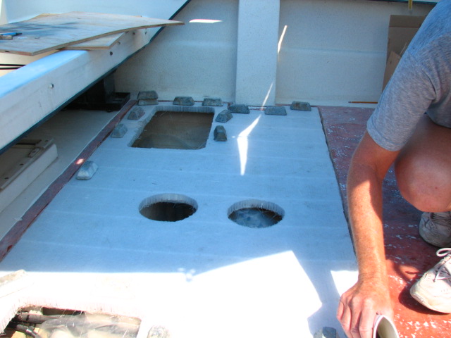

The core of plywood will be excessively heavy at 75#. We made the new floor of NiaCore(hex cell 4# 4x7 sheet). You can also use Balsa as originally, or one of several foams. The Balsa has excellent characteristics, and if sealed will not give any problems--actually better than many other core materials. It is the I beam construction effect giving the stiffness, not the rigidity of core material such as plywood. The original balsa is bendable if not laminated on both sides.
In the 2005 C Dory 25, the deck is tabbed in after the fuel tank is placed or may be part of the original molded deck/cabin sides. On the 2003 C Dory 25, I owned the gel coat was rolled on.
We found that the inner layer of glass in the cockpit deck was poorly adherent to the balsa core. The "I" Beam strength of the cored laminate is defective if both upper and lower skins are not well adherent.
I would use a polyester/cabosil slurry if putting the new core material into the previous underside of the cockpit deck. Use a notched trowel to spread the slurry. Epoxy would be a bit stronger. Saturation and water proofing of the edge of plywood is difficult with polyester. Epoxy is far superior, and should be mixed with a filler, with the core material cut back slightly.
You can find other photos of our rebuild of the cockpit floor on page 5 of my album.
