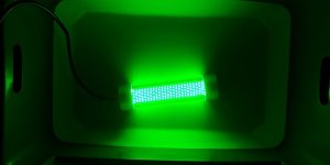

I added a second house battery for an underwater light for blackwater diving. I run it in parallel with the other house battery.
