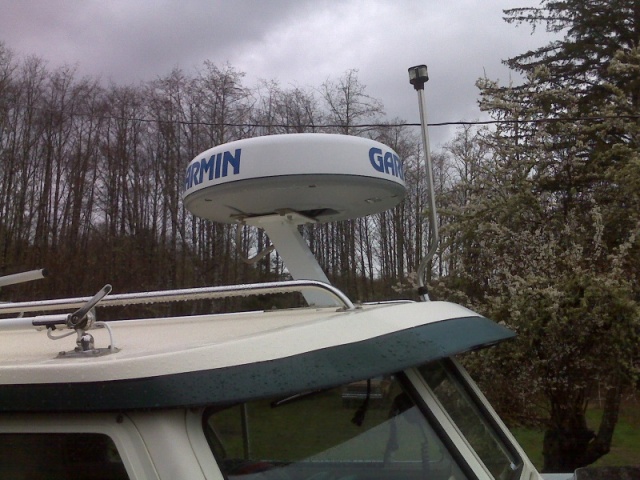

The radome on my CD25 is the first generation Garmin GMR41 24" and I don't think it looks too big up there. Garmin came out with the 18" a short time later and I thought for a while that the smaller unit would've been a better fit but I have since changed my mind and prefer the 24".
Like the late great Dusty Lampman told me when a couple folks teased me about it at a gathering, "The bigger the array, the better the definition." I'm going with that!
If you are mounting the radome down low the 24" will be perfect on your CD22. If on a pedestal or an arch it might stand out more than you like. But mine looks just fine on a pedestal and my CD25 is only 10" wider than your CD22.

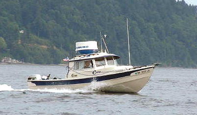

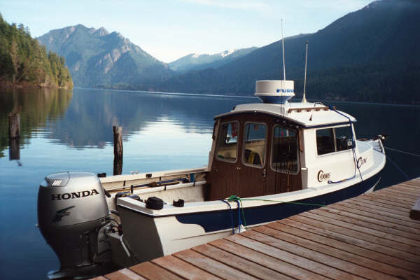

The reason folks were teasing me is because we all used to make jokes about the old Furuno monster on C-Lou. After he replaced it with a new smaller unit they dubbed me as the guy with the biggest radome.
The original C-Lou megadome:
