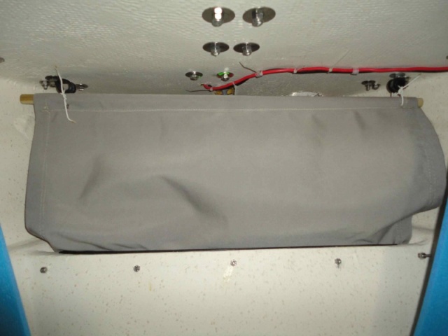

I made a Sunbrella cover for the open part of the locker. Also as C Wolfe, used an eye nut on the inside threads of the bow eye. I make the "attachment" to the boat, with several passes of 1/8 "Dacron line to a tight eye splice at the bitter end of the anchor rode. This makes it easy to cut the bitter end free if it becomes necessary.
Below is a photo of the canvas. I sewed a sleeve in the top of the cloth, and then ran a 1/2" dowel through it--with 1/8" Dacron lines to the eye hooks above.

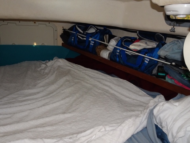

Probably a 12" x 18" hatch cover would work. This is about the size used in some other C Dory boats. I have not seen a 22 with this, but no reason it could not be made this way. The 25 and Tom Cat 255 both have a hatch.
At the upper left is the hatch on the 25 "Thataway" to the anchor locker. There are back packing pads against the hull for insulation, which is the blue material over the lower part of the hatch.
