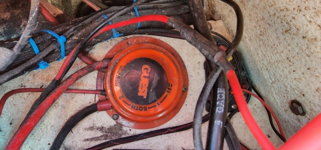

I had been assuming that the Guest 3100 dual battery switch connected either Battery 1 or Battery 2 or both to the motor, but I don't think I ever tried to run the motor from Battery 2 until today. It turns out that I can start or tilt the motor with the battery switch set to 1 or Both, but not with the switch set to 2. Likewise, the VHF radio, depth sounder and the nav lights, bilge pump etc. switched through the panel on the dash work only with the battery switch set to 1 or Both.
Engine gauges on the dash come on with the ignition switch (i.e. the Suzuki key) no matter where the battery switch is set - even set to Off. Bilge pumps, which I though should work with the battery switch Off, work only with switch set to 1 or Both. Despite the dual battery switch, it appears to me that Battery 2 is connected in parallel. I haven't opened the battery switch, but I'm betting both battery + leads are connected to the Bat 1 connection inside. I don't think the Bat 2 connection is used.

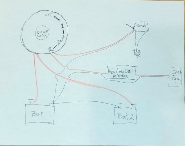

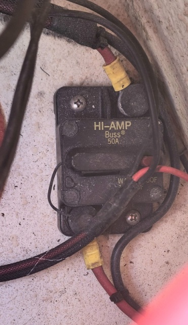

The wiring is an impossible tangle, with all the wires and cables from the outboard zip-tied in a bundle in the battery compartment with the electrical wiring for the rest of the boat. However, I cut the zip-ties and got a rough idea how it's organized, as in the following sketch.
Not shown are a bunch of unidentified wires attached straight to the Battery 1 posts. I know the washdown pump is one of these, as is a ground for the through-hull that feeds it. Maybe some go to the Suzuki gauges and ignition?
There appears to be just one red wire from the outboard to the dual battery switch. Does the outboard charge the batteries through this wire as well as taking power to run the starter and tilt motors?
Here is the battery switch:

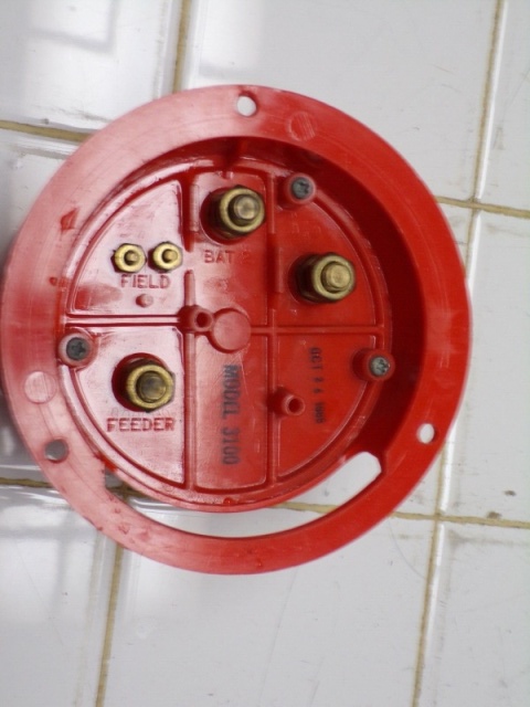

It looks like a Guest model 3100, in which case, these would be the connections (from an Ebay photo):
I assume the Feed goes to the outboard starter and tilt motors. A smaller red wire (from the Fields posts?) runs from the battery switch (from the Fields posts?) through the High Amp Buss and apparently to the switch panel on the dash for the running and cabin lights, windshield wipers, bilge pumps etc.

The "field" is to prevent the diodes in an alternator from burning out when switching batteries, and there being no load. Modern switches have "Make before Break" and do not require connection to field current. I am not even sure if it is possible to use the "field" terminals in your outboard. If indeed you have this same switch, rather than a more modern one, it should be changed out....A boat built in 2005 should have the proper switch.

ABYC requires that the output from the switch or battery be fused within 7" of the battery (That is what the 50 amp breaker is for--the engine is not included in this breaker.)

Ack, I misspoke. I think the two batteries are wired in parallel. That is the negative posts are tied together, and I think the positive posts both go to Bat 1 in the Guest switch. I guess I'm going to have to pull out the Guest switch to confirm.
I don't understand how the alternator charges the batteries. There is only one wire from the outboard to the Guest switch. Does this both provide battery power to the starter motor and send alternator power to charge the batteries? The only other possibility I see is that a separate alternator wire connects directly to Battery 1 and charges both batteries.
None of the wires are labeled, and most are hidden in identical braided jackets making them extremely difficult to trace. I feel like I should rewire the boat to understand it, but I have no covered space to do that. Frustrating!

Well, this is embarrassing. I tightened the cable connections to Battery 2, and now the Guest switch works as expected. If I remove the leads from Bat 2, there is no voltage across them with the switch set to 1, 12.6 V with the switch set to Both and no voltage with the switch set to 2. If I reconnect the cables to Bat 2, the motor starts with the switch set to 2. This makes me feel better.
I am still wondering about the alternator connection.

Yes, you need to pull this switch and find out what is going on. It is also possible that the switch is bad. Irregardless, you need to determine the start of charge of the #2 battery. Also follow up on the VSR and monitor for battery status.
There will be a positive and ground to the outboard (Plus the bundle going to the ignition switch, which controls, start solenoid, tilt, trim. and "off".)
The outboard charges which ever battery is connected to the positive wire from the alternator (charging device) on the outboards--this is usually the same wire as goes to the starter. It is possible that the motor hot wire is to the terminal on the battery switch. There is a second charging circuit on some of the newer motors. You would have to check the manual on your engine to see if it has this feature. If it does, then you don't need the VSR. The second charging circuit would go to the #2 battery.
There are several ways to trace wiring--one is a signal generator-which is what I use for trouble shooting. The "make or break' method is to disconnect a wire, and see what does not work!
Yes the wires will all be bundled. Most likely extra wires have been added. Some boats have color code. But, be advised that in that era C Dory would often change color of the wire in its run if not long enough, and seemingly just pick any size or color they had handy. (And that is where some of the issues occurred.)
Before rewiring, you want to draw out the circuits in the boat. If there is no corrosion on terminals or wires, then no real reason to rewire. I had a 20 year old boat which spent its first 10 years in charter service in the Caribbean. I had to completely re-wire that boat, because of corrosion in the wires as traced back from the terminals.
Many of these questions can be answered in the links I gave you above. For example the proper use of the 1/2/all/off battery switch on the Compass Marine how to site.
A tone generator, can be used on non energized wire circuits. They run from $19 to over $2,000. Fluke has a good one in the $120 range, and Klein in the $60 to $70 range.
When replacing wires, always use marine grade, tinned, wire. Also with the crimp fittings you want adhesive heat shrink tubing either built in--or use the adhesive heat shrink tubing over the terminal crimp. A good crimper is a basic tool --see the compass marine site for recommendations. There are lots of videos on the internet to learn to use these various instruments.
