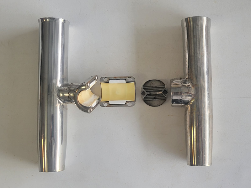

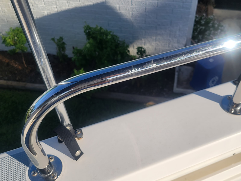

Another vote for flush mount.
I started with the cheaper rail mount ones and they didn't hold too well and scratched/dented the railing when any big mahi or tuna hit the line.
I switched to the style on the left to avoid the scratches, but they still like to rotate a little on the rail if something big gets on.
