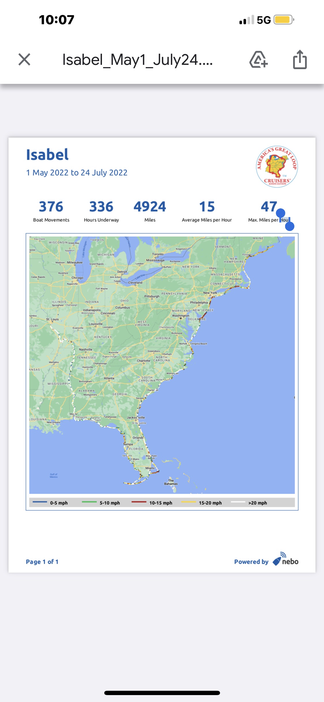

I did a mix of both daninPA. Parts of the ICW are beautiful and off the beaten path, but other parts are congested with lots of boats and the occasional dangerous operator and long no-wake zones. I really liked the parts of the ICW along the southeast in Georgia and the Carolinas but I generally preferred runs in the ocean when conditions permitted.
Exploring the Everglades and my open water runs (Apalachacola to Steinhatchee, Middle Cape to Key West, Key West to the Dry Tortugas, crossing the Gulf Stream, and from the Hudson to Grand Manan) were my favorite parts of the voyage.

Do you have a blog site--I would love to read it. At times I had fantasized about doing the great loop in my 18' Caracal Cat--a very capable boat, but with only about 26 gallons of fuel. Thus one would have to markedly increase the fuel, since in looking at your track, you were on a plane most of the time.
