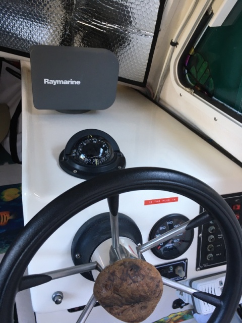

Getting ready to replace our chartplotter with a 9" Garmin, and a new SH VHF with ais receive. The existing icom radio has never worked well since we got the boat, now I'm reading that maybe it's compass interference (although the radio's pretty old, so maybe it's just the radio).
Anyway, why in the heck would someone mount a 4 inch compass on the dash of a 16' - although there are few other options. It's going to be (and already is) about 9" away from the chartplotter, and about 14" from the radio, as the crow flies. I like having a compass, but can't figure out any other place to put one. And it's going to leave a big 3 inch hole in the top of the helm (we can find a way to deal with that Smile
Am I maybe being too paranoid about how the compass will affect the electronics? Thanks! - Karen

oops, forgot the photo Smile

Well, maybe the compass will have an affect on the radio, but I would bet my bottom dollar, that the radio, that close to the compass, does have an adverse effect on the compass. You could do like the early Ranger tugs, (an maybe they still do this), get the proper distance by mounting the compass out on the fore deck. Shocked

Swing the compass and make a compensation table. You want to do this MFD on and off. Also with lights on and off. Anything within 3' can affect the compass.
I happen to like the Sun Compass to use in swinging--and when it is easy one will do it more often.

Thanks! The only reason I can imagine relying on the compass is if we were to lose power during sudden fog, unlikely Smile Maybe we'll take it out, install the radio and chartplotter, see how they work, then put it back in to see if it affects either. If it does, maybe I can find a place to put it on a slider, like underneath one of the seat boxes. Really don't want to put it on the fore deck, if only because we would have to drill holes in the boat Smile

As Harvey noted. The compass will not affect the radio or chart plotter. It is visa versa. Any ferrous metal will affect the compass as well as electrical circuits and DC electricity in parallel wires. There is most likely part of the push pull steering system which may also affect it.

On my 16, my compass/MFD are mounted in the opposite configuration. The compass is forward of the MFD and tucked in under the window. That gives me another 2-3" of separation!! Probably makes no difference. Also, on a compass the size used in a 16, the compass lines are in 5 degree increments. Accuracy is relative. If your compass is within 10 degrees, that may be as accurate as you will ever see. Just the nature of the beast. When on plane, most little compass cards dance around. Navigating by sunlight or the direction of the seagulls may be about as accurate.
Look at the compass and turn on the MDF. Any movement? But activating the radio and the MDF isn't the only interference. They may interfere even when off. My Garmin MDF has a slot for a SD card. The cover of the slot is held shut with a magnet!! Opening the card door moves the compass, meaning that the magnet probably interferes whether open or not. Maybe Garmin thinks that magnetic compasses are obsolete and, thanks to Garmin, they may be.

Yeah, I think we're going to live with any deviation - the compass is almost 6" diameter, with a huge hole in the helm dash that I don't want to deal with right now. I think it'll be close enough for our purposes Smile
