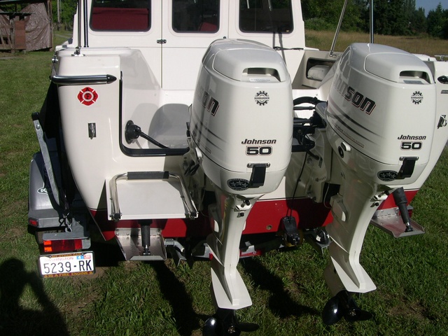

To answer your question though, I don't see any reason you couldn't put twins on a single engine boat, but you would have to seal and repair the holes left from the old engine mounts. Possible you may need to relocate the drain hole in the splashwell also.
This isn't my boat but I found this picture
