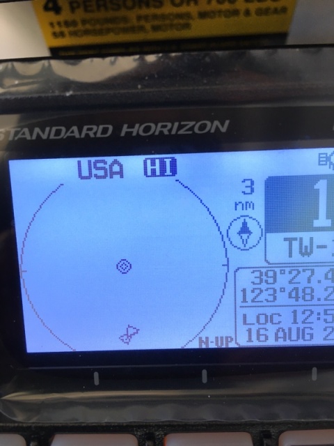

The one thing I don't understand is that no matter what I do, the screen image has north at the top, instead of orienting according to the boat. (The compass is set for "course up), but the little icon at the bottom of the screen alternates on its own between "N-up" and C-Up", and C-Up doesn't last long enough to figure out the changes). This image is from sitting in the driveway, pointing nearly due south, with the ocean about a half mile to the west with a relative N-S coastline. I watched several boats for a while, and they appeared to the left of me on the screen (which is where they would be if I was pointing north), and sometimes at the top of the screen (on land) Smile Maybe this will change once it's hooked to a chartplotter Smile Or maybe I just had higher expectations ...

I still haven't figured out why the AIS screen is always pointed north, no matter the direction the boat is pointed. However, some of the sporadic activity, i.e., the fact that our boat is not always indicated with the proper black icon as in the photo above, maybe related to the antenna? That's the only thing I can think of Smile

FYI, if the boat is not moving then the GPS system in the radio has no idea as to what direction the boat is (not) travelling (pointing).
GPS direction is dependent on obtaining a position, temporarily storing that position, getting a second position and comparing the new position to the old in order to get a direction of travel. It's likely much more complicated than this simplistic explanation, but suffice it to say that if you are not moving, it has a difficult time computing direction. (It's not really a compass at all).
This may be the problem you are experiencing with the boat at rest?

CC Rider, geez, thank you Smile makes perfect sense

I agree with Chris, I think he is onto something and you (the boat) need to be moving for the GPS and AIS to do their computing and locating.
